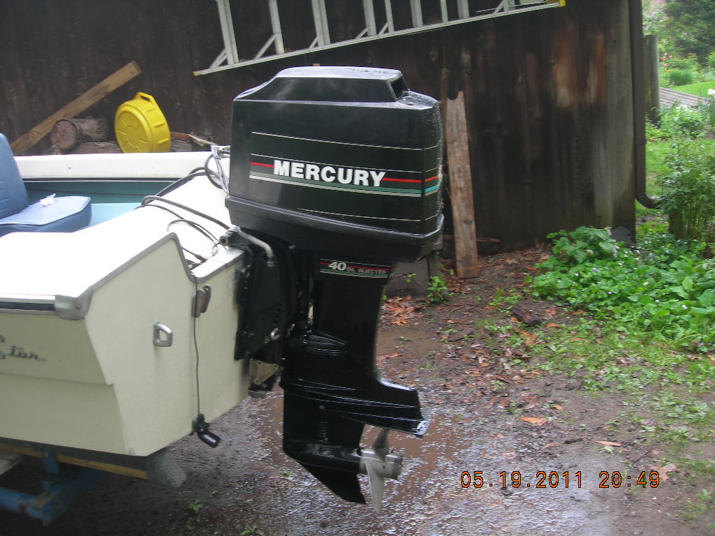

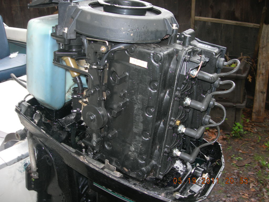

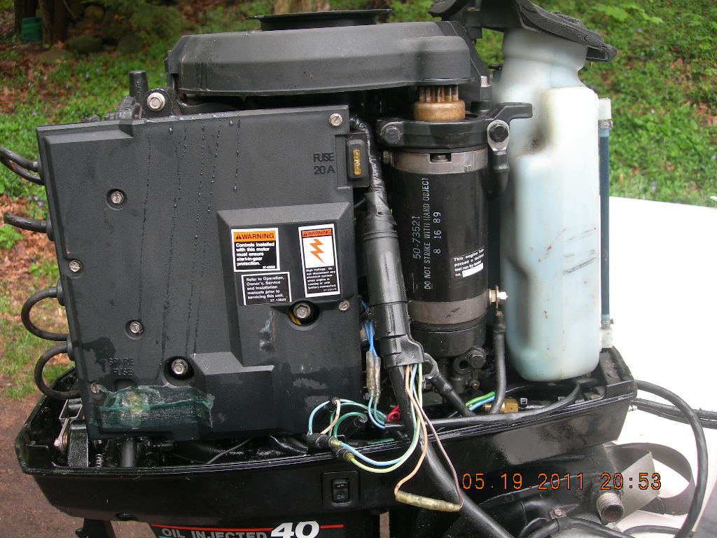

I got the correct serial number ( 0C267810 ) which I now believe makes it a 1990 Mercury 40 Classic.
Here are some pictures of the motor:

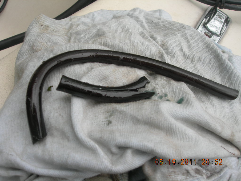

Here are the broken pieces of oil line I found in the head:

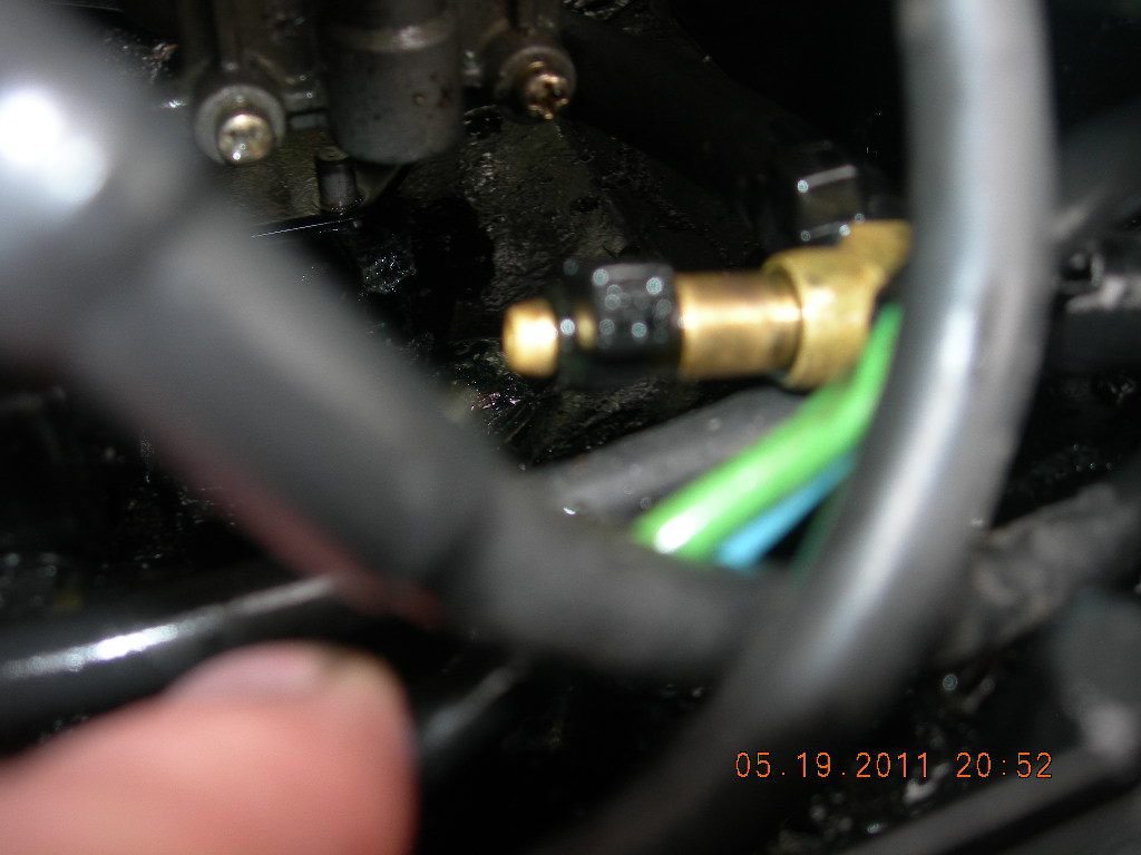

And the fitting with the tie and a piece of the line still on it:

you will have to pull the head to see if the 50 will mate to the mid section. It may very well because the blocks appear to be the same. I worked on one of these and disabled the oil injection. Still running strong.
The oil lines are cheapo's over time the oil gets tanic and breaks down the lines. Most people just do not pay attention to them and then OOPS!

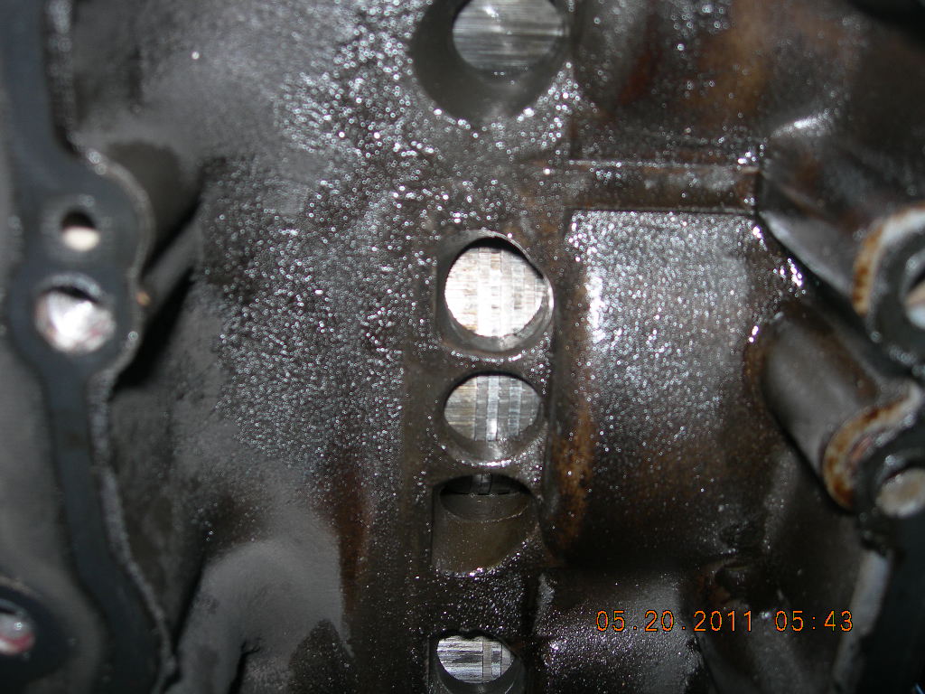

I started tearing down the 40 and will hopefully have the powerhead re-bored and with new pistons should be a fine motor again. Of course I need to find a lower unit for it too now.
Picture showing the scored pistons/rings thru the inspection ports.
