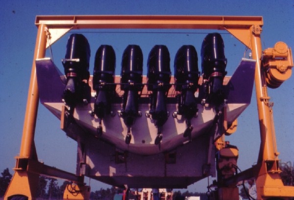

Personally - I would run (2) 1500 Stack-6s compared to a new 4 stroke any day.
Primarily because I already have 'more than 2' 1500s and can't even think of affording the purchase of a fancy new 4 stroke.

Wow, is that for real? 6 outboards? What is it, a tugboat?
