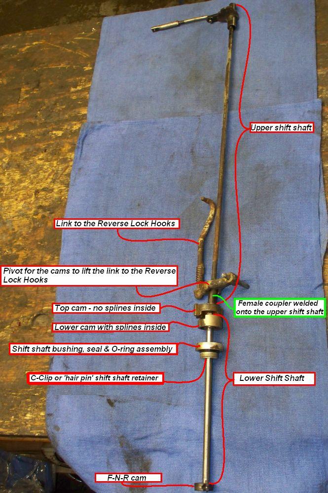

I have also attached a picture of the related components on a Mark 55, 58, 55A, 58A, etc. Other model Mercs may have different external cams and reverse lock related components, but the lower shift shaft and R&R principles are the same through the late '80s in many cases.
