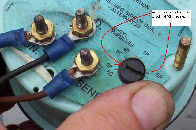

I believe some of the guys can explain how to use an automotive tach reading off one of the coils, but I prefer to use a new TeleFlex tach that comes in a variety of colors, requires 12v, a ground, and a sender wire connected to either of the (2) yellow wires at the rectifier coming down from the 12 pole stator under the flywheel. Set this style tach on the 6 pulse setting and you are good to go.
If your internal harness does not have a tach sender wire built in simply run one from the rectifier (either yellow wire terminal) through the hole in the lower pan placed there to access the bottom screw on the bottom fuel pump, and run this wire along side your harness going up to the controller & dash.

Mr 88,
The back side of the tach should be labelled 'IGN' 'GRN' 'SEND'.
The 12v(+) goes to the IGN.
Engine or battery ground (-) goes to GRN.
The SEND needs to go to a terminal on the rectifier that has a yellow wire from the stator on it.
Be sure and do voltage and continuity tests on any wires you consider putting on the tach to avoid damageing the tach.
If all the wires are connected right and the tach won't work - it is possible the rectifier or stator have failed and are not putting out 12v(+). The rectifier failure is most common.
Thom

Re:Need tach for 65 Merc 1000 15 years 5 months ago #32221
hook up to on off with the key 12V.
