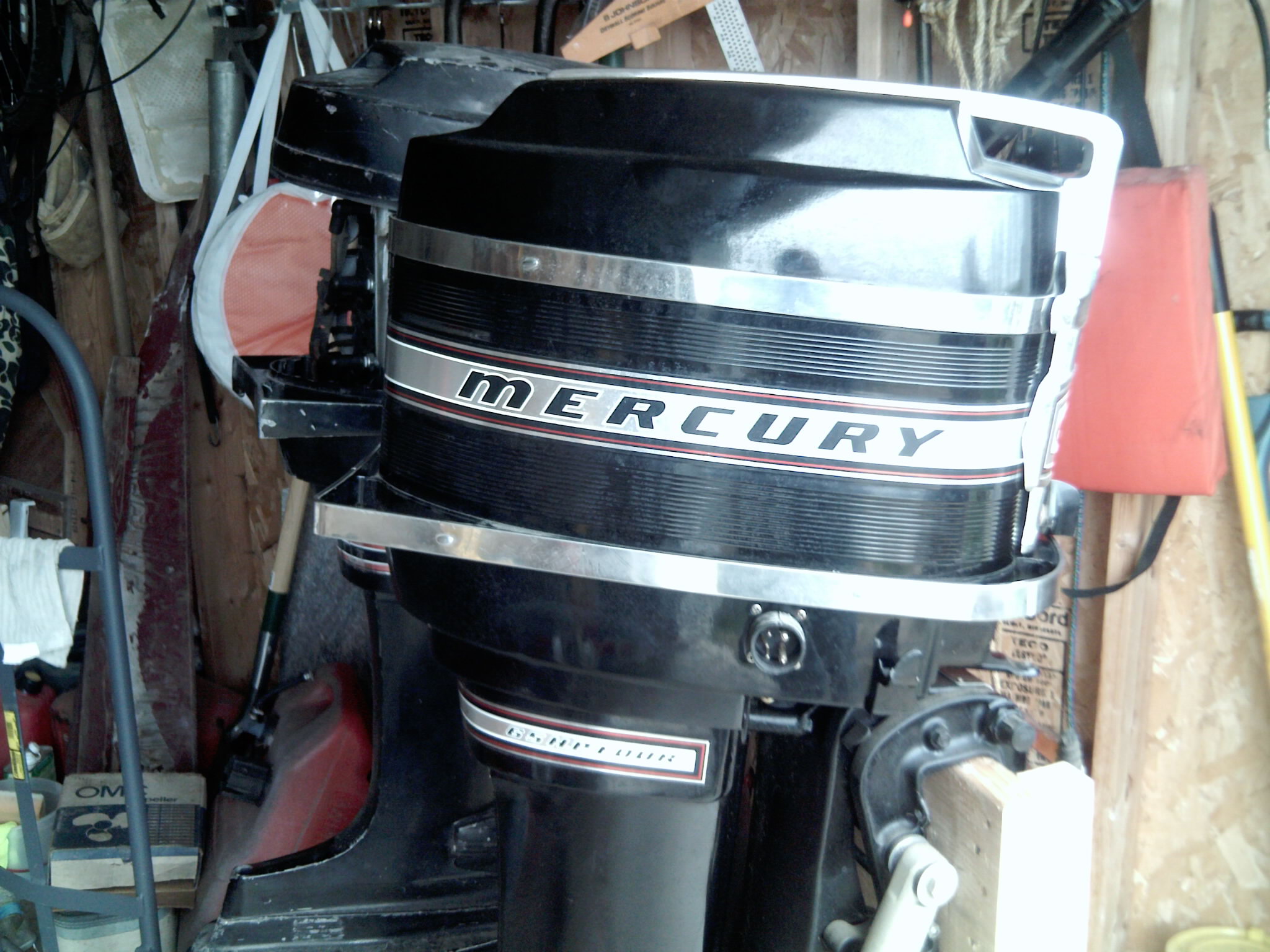

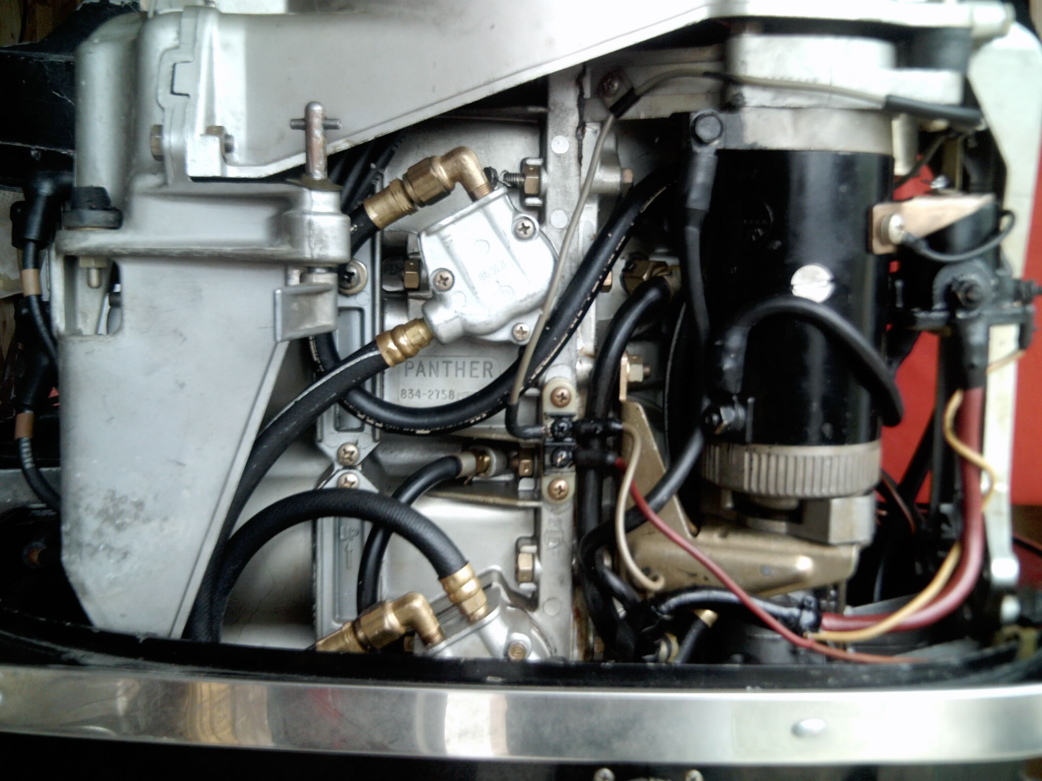

Re:1967 merc 650 15 years 5 months ago #32112
here is a couple pictures of her, she is still a little dusty but it will shine up like a new penny
Re:1967 merc 650 15 years 5 months ago #32120
Jetflite,
That is a nice clean 650. DROOL-DROOL-DROOL.

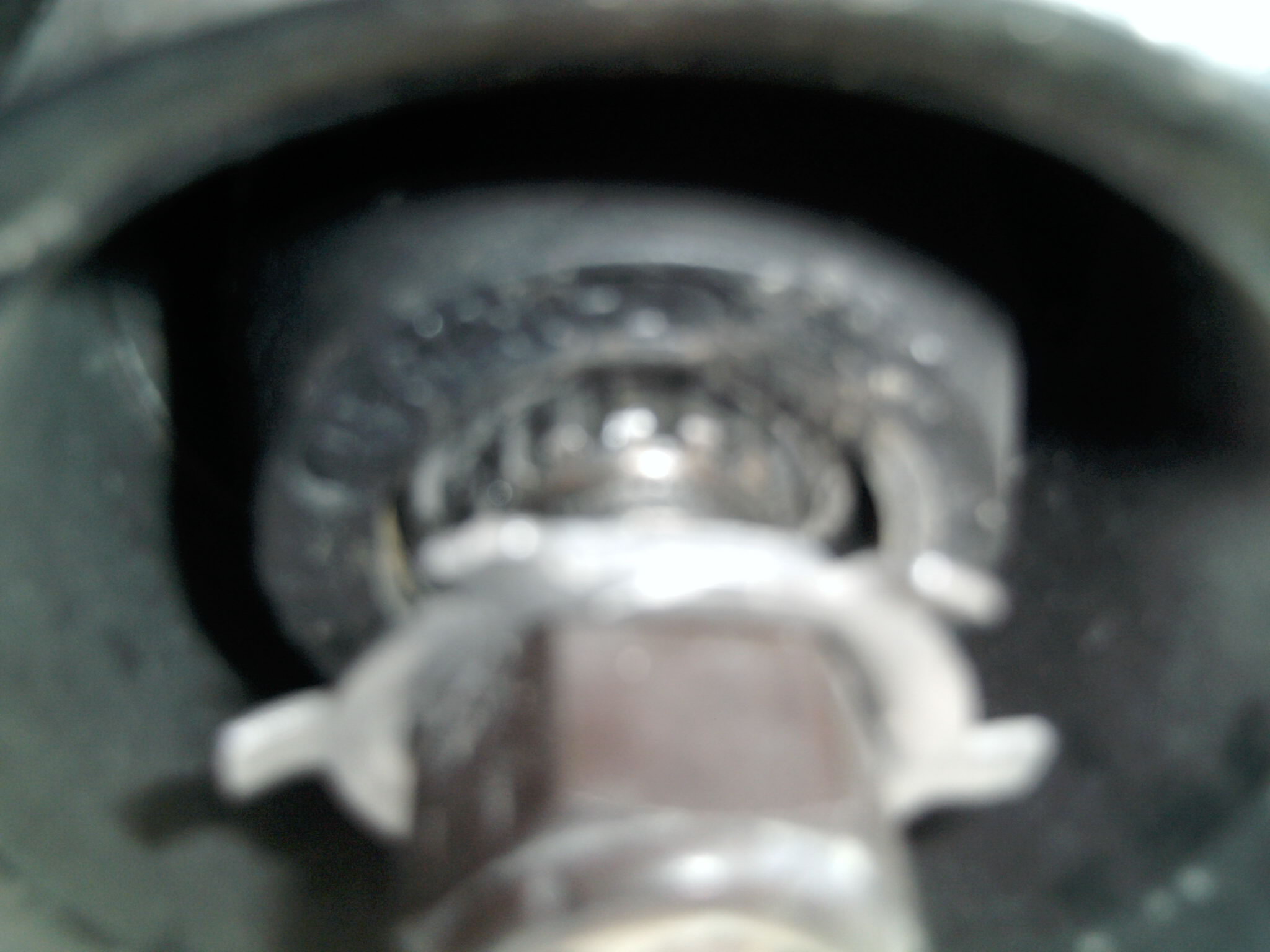

Re:1967 merc 650 15 years 5 months ago #32216
There is a locking washer that grabs the end of the splines that is not on your drive shaft in that pic. It goes between your prop and the bendy lock tab.
Conrad
