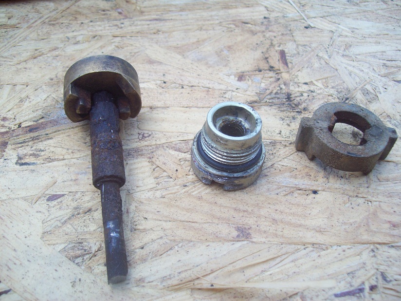

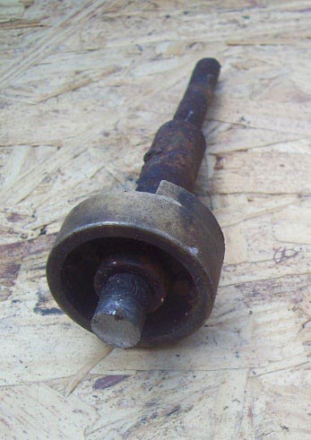

Here are the cam pics.

Do you think I need them or can these cams be used with new rods?? Thx, joe
Re:Mark58 Parts Needed 15 years 5 months ago #32188
new shafts and seal and hair pi on lower shaft and you can use your old parts. good to go.

Thom, I used a hacksaw to disassemble this one!!!
What is hair pi?? I'll take your upper and I'll take Thom's lower.
Mad Props, you have the seals? Thx Joe

before I ship you the upper shift rod ....remove the cut rods from the splined reverse cam to be certain the splines are still going to be good

Are you talking about the one in the pic with the cam? That one is cut off on both ends. The piece down in the foot came out easy and looked good.
Re:Mark58 Parts Needed 15 years 5 months ago #32208
joe you need to remove the 2 cut off parts of the shift shafts that are still in the reverse cam

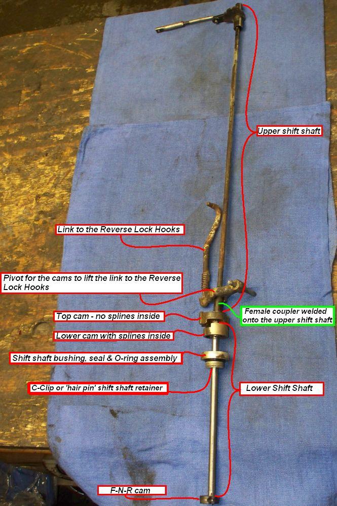

Re:Mark58 Parts Needed 15 years 5 months ago #32306
Joe,
Please review the attached picture and see if you need anything other than the lower shift shaft from me before I mail it off to you.
Thom
Re:Mark58 Parts Needed 15 years 5 months ago #32323
nice Doc, another lesson from the master.
