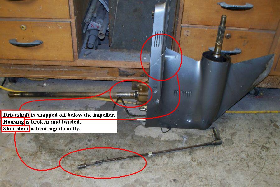

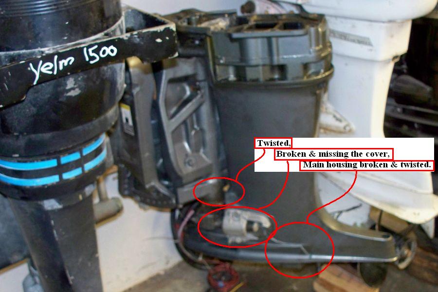

Hitting a deadhead or other obstacle with the lower unit can be a disaster with the integral PT&T.
The attached pictures are of a 60 MPH impact.
Thom

Thom – was all that damage you displayed to an engine with the stock tilt/swivel bracket? Or a PT&T – looks like a PT&T
Re:What would happen if...... 15 years 5 months ago #32195
Peter,
It is a PT&T like the one you're working with.
I still feel they are the best PT&T from Merc.
Thom
