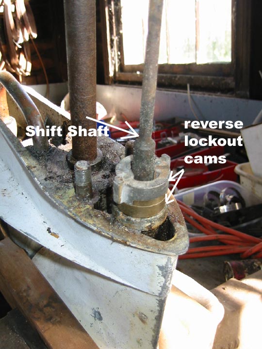

Joe
first pic shows the top and bottom shift rods coupled together as it lokks if inside the DSH "drive shaft housing"

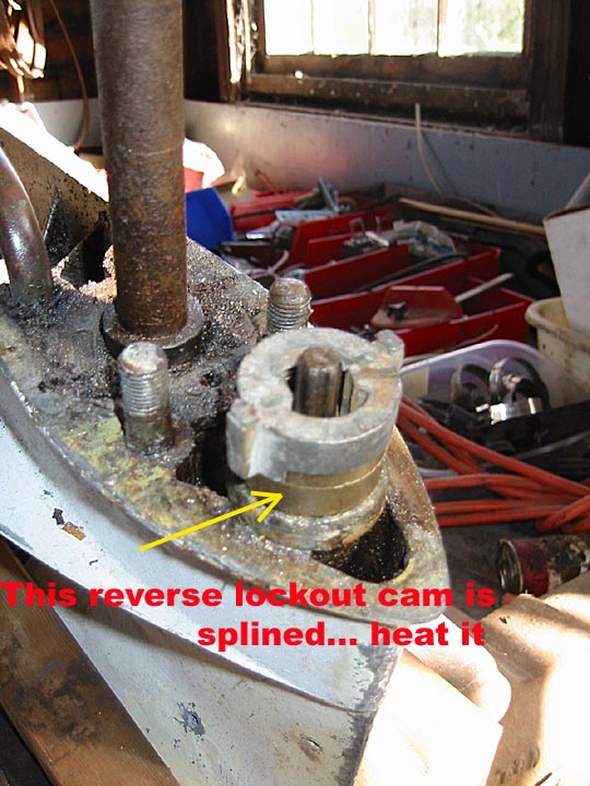

next pic shows the 2 reverse lockout cams the bottom one is splined and the one you will be able to see and need to heat if you cant see the shift rod

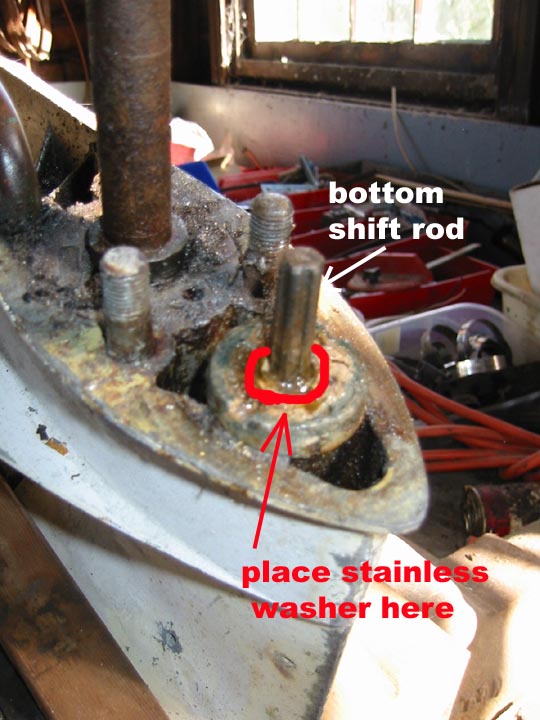

last pic shows the splined bottom shift rod....while were here....if you have a problem with your motor not locking in reverse in kicking up
for a quick fix that works well place a stainless washer where shown in the pic, this will increase the travel of the lock out rod and give you positive engagement

get to the coupling by aiming the flame down thru the opening in the front of the midsection.

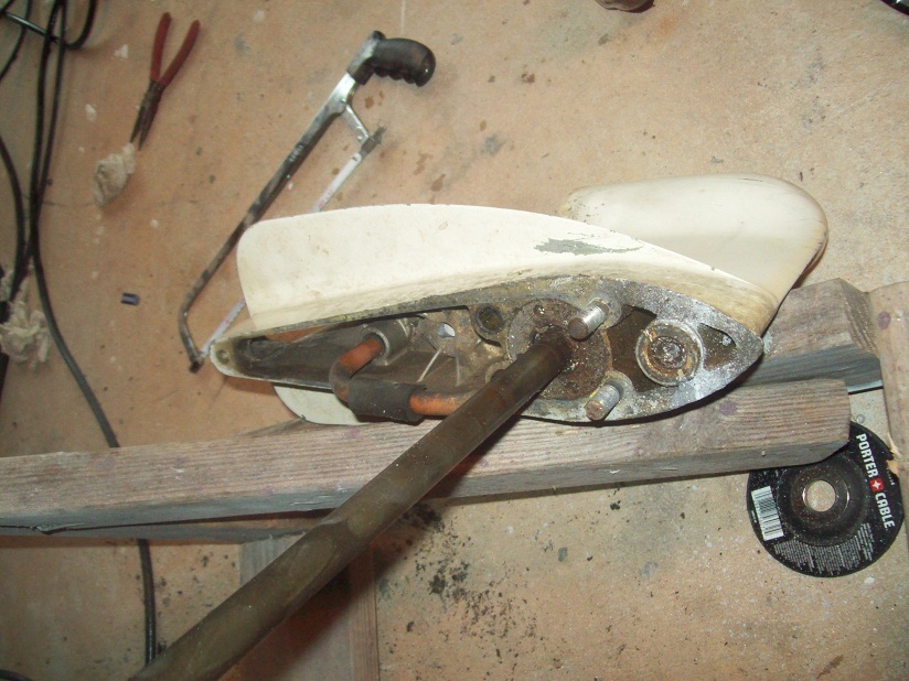

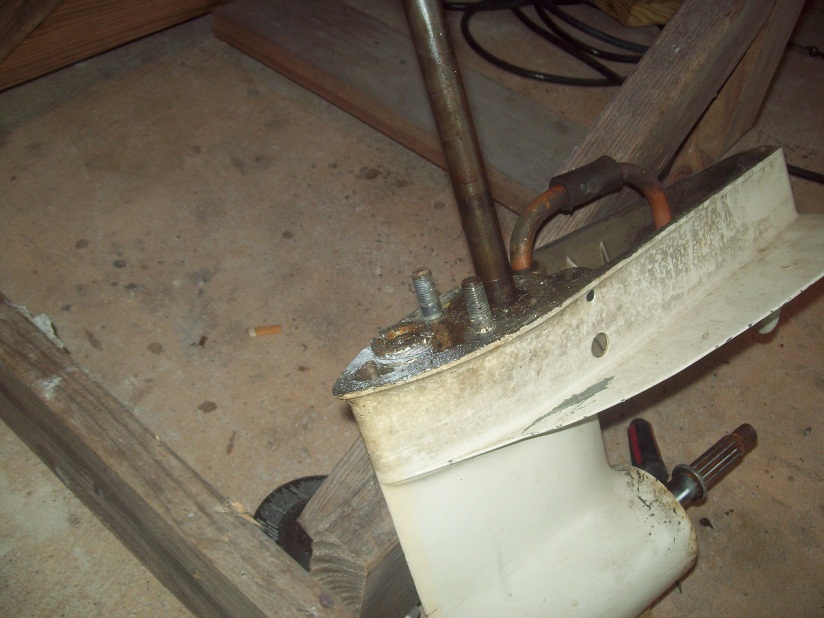

It's a gone pecan!!! Just hacksawed it and plumped right out seems to be the lock out rod to keep from jumping and the other one is the one that goes to the lower cowl, That's still stuck in mid, might have to cut it too to get the shifter out from the cowl.
