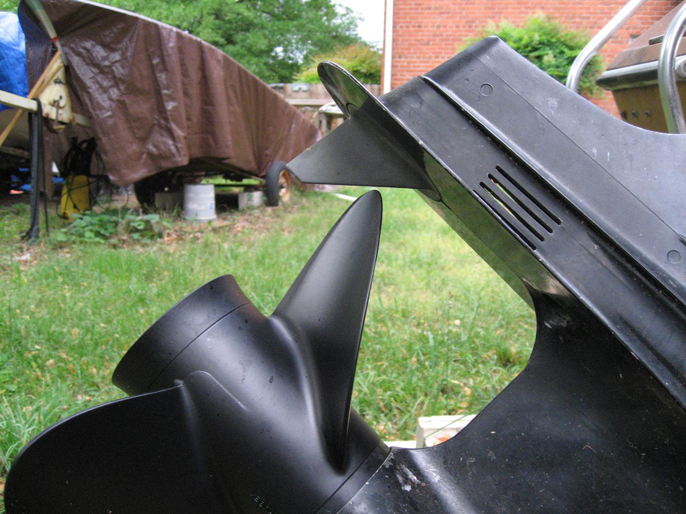

With a new Rubex Solas prop on my Mercury 1400, there seems to be not alot of clearance from where the prop passes near the anode. Maybe about 1/2 inch.
Is this normal?

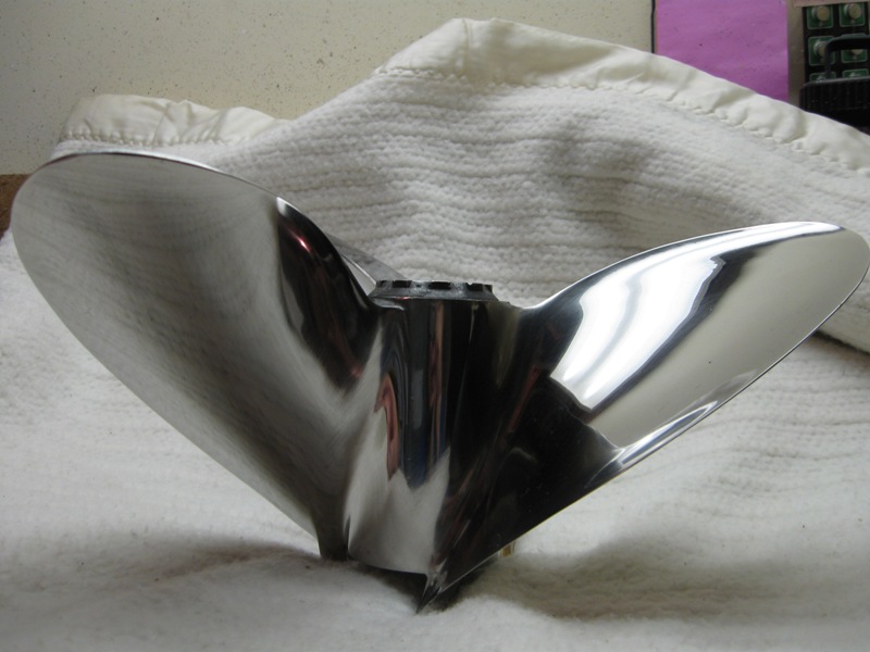

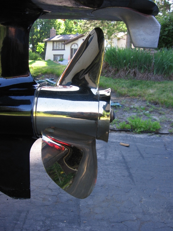

One-half inch clearance should be fine. The aluminum blades may flex somewhat under acceration but not that much. Mercury makes a setback trim tab that is required for high rake props where the blades sweep back. With the setback trim tab on my Mercury, the chopper prop has about 3/16" clearance and I am thinking that should be okay. The first picture shows a Mercury bronze prop and a setback trim tab, and the second the rake of a Mercury Chopper prop.

That's a good idea... heres a picture of the clearance as is... seems too close to me!
Hello, World!!
Re:New Prop, Clearance to Anode 15 years 5 months ago #32808
Just take a grinder and cut back a nice notch say 1/4-1/2 where the tip is closest. Probably does not need to be done, but might as well if you have the time.
Prop shafts and hubs can flex in and out. Mostly in.
PS your prop looks like its just barly gettin into the gearcase housing. Does it push on any further? Does your prop shaft move fwd when you push on it?
Conrad

I really had not tightened it down yet, so yes, it probably will move forward... but a grinder is what I thought of also.
