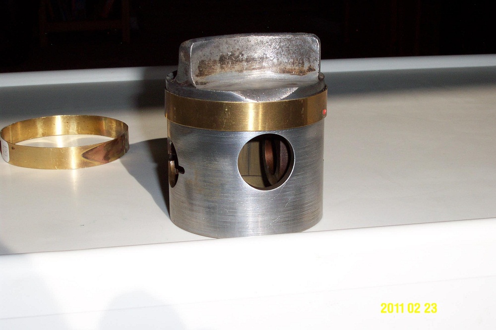

This is what I have done, the brass ring is made from flat brass from the hobby shop, soldered in a circle the correct diameter to hold the rings and clear the piston. Oil it up and the ring slides off, the rings dont break and the ring slides up the rod. Once the rings are past the entry of the cyl, the brass strip has done its job. You can either cut it off then or let it ride up the rod where it is easier to snip. I prefer to put the pistons in the block using the brass ring, that way I can "feel" each piston and how it moves in the block. The brass ring is then re useable for the next piston. I put a flat aluminum bar across the crank case for the end bearings to rest on. Then I bring the rod up to the crank and bolt it on. Works for me.
Re:ring compressor 15 years 6 months ago #31097
Would help if i attached the pic.
