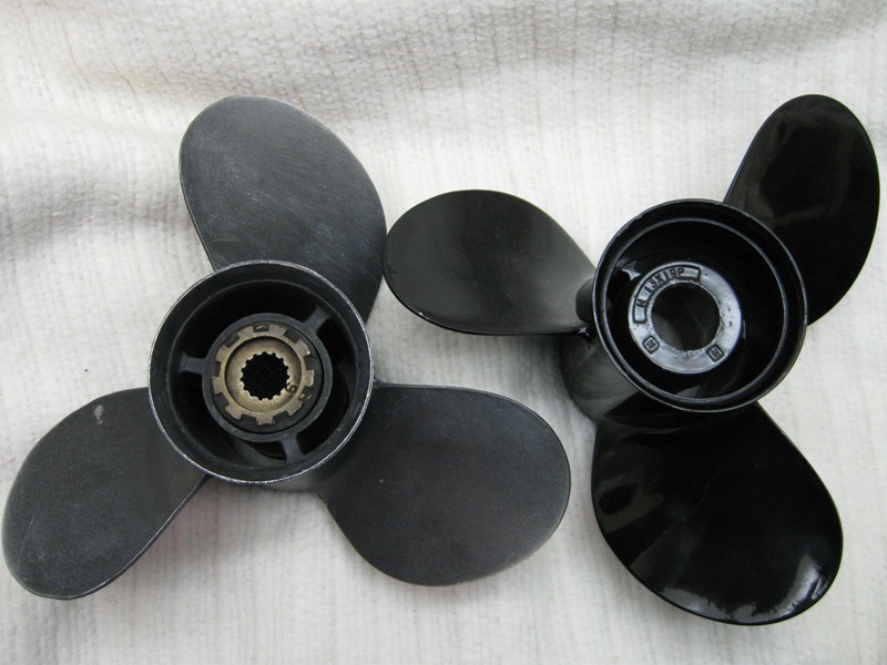

I have seen a Solas prop versus a Mercury prop, both in 19" pitch. The Solas did not seem sturdy - thin metal and flimsy. The Mercury would be designed and tested for Mercury outboard motors. Everything else being equal, choose the Mercury prop.
Picture is of two Mercury 19" pitch props, one with built in hub and the other for a hub kit.

I have used the solas rubex on my 1150, 17P for running in a bass tournament in a storm. It stood up just fine. The advantage is you can change up in pitch easily with a different prop, same hub. Make sure you get the correct hub kit and that you have the correct thrust washer on your prop shaft. Don,t let the thickness of the blades fool you, Metallurgy is key.
