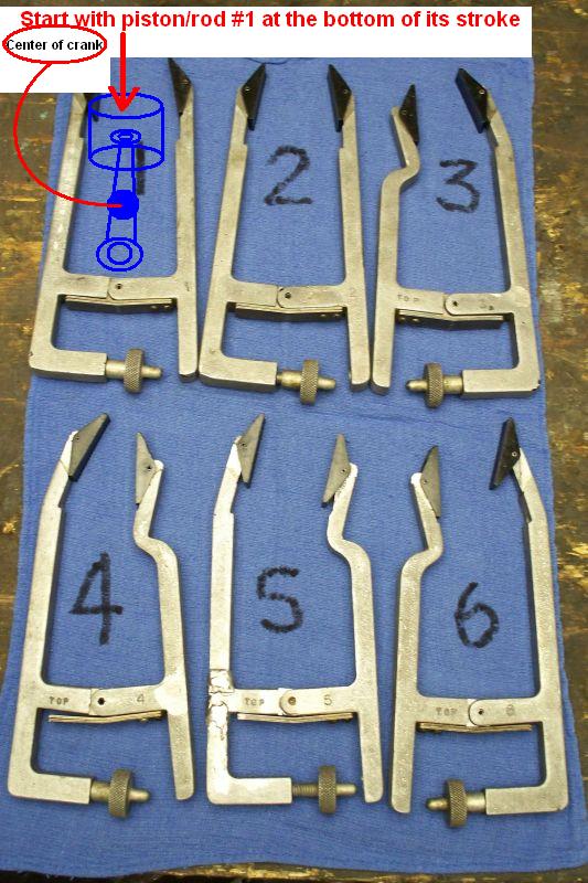

There are special Merc designed ring compressors.
I'm pretty sure the smaller motors - like your 44 ci would use a smaller set of ring compressors than the medium sized 76-90ci 4&6 cylinder and the larger set for the 99ci like a 1500, etc.
I believe there was a helpful post here not too long ago that folks shared alternative ideas when the Merc compressors aren't available.
Maybe someone can track down that post and related replies??
