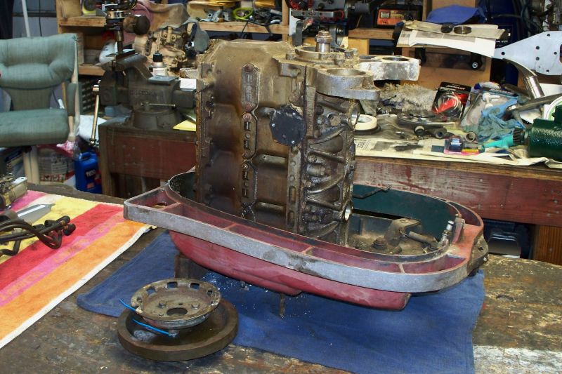

I just about had this old Mark 55E running after it slept in the pole barn for many years. I replaced points/condensors/impeller etc. and then the starter died just as it was about to kick.
I tried tearing it apart to clean up the but I think the brushes are gone. I am having a really hard time finding a replacement. It is a strange beast where the bendix doesnt extend up to engage the flywheel but rather slings/swings sideways into it. Here are a few pics and I am hoping someone might have something for me.

That style starter is very hard to come by. Yours must be a 1955 MK55
You can replace it with a newer style starter, but you would also need the newer style flywheel.
My advice is to tear your starter apart and replace the brushes. Any starter/alt repair shop will have brushes for you. Take it in and show them the brushes, and they will find you some usually.
Starters are usually pretty easy to repair. But I have never worked on one exactly like yours before.

You are correct Conrad...it is a 55 Mark 55E. And yes they are REALLY hard to come by. I am trying to find the time to get it down to Tim Calmes at Silver Lake who is sure he can round up some brushes at least and maybe even a starter. I just thought I would make things easier for him if I could find a starter.
I have it all torn apart(did it last summer) and may have a heck of time figuring out how to put it back together now.... I leave that up to the expert Tim.
Thanks for the idea about using a newer one with a different fly wheel.

Correct me if I'm wrong, but I don't believe the later model starters will work, because the '55 block doesn't have the castings for the retaining bolts required by the later starters.
Thom
Tim should be able to fix you up with brushes. He has a GREAT inventory of NLA NOS besides all his used goodies.
T
Re:I Need Starter for Mark 55E 15 years 6 months ago #30613
Thom is correct the mount flange is different on that model
I think a guy could maybe fab up a plate to clamp the newer style starter into the blocks starter ring?
Re:I Need Starter for Mark 55E 15 years 6 months ago #30622
Thom your correct! I forgot :( Should be workable with a top plate like Michael mentioned.
Conrad
Re:I Need Starter for Mark 55E 15 years 6 months ago #30645
I'll see if a standard starter will fit the main hole for a starter and report back.
