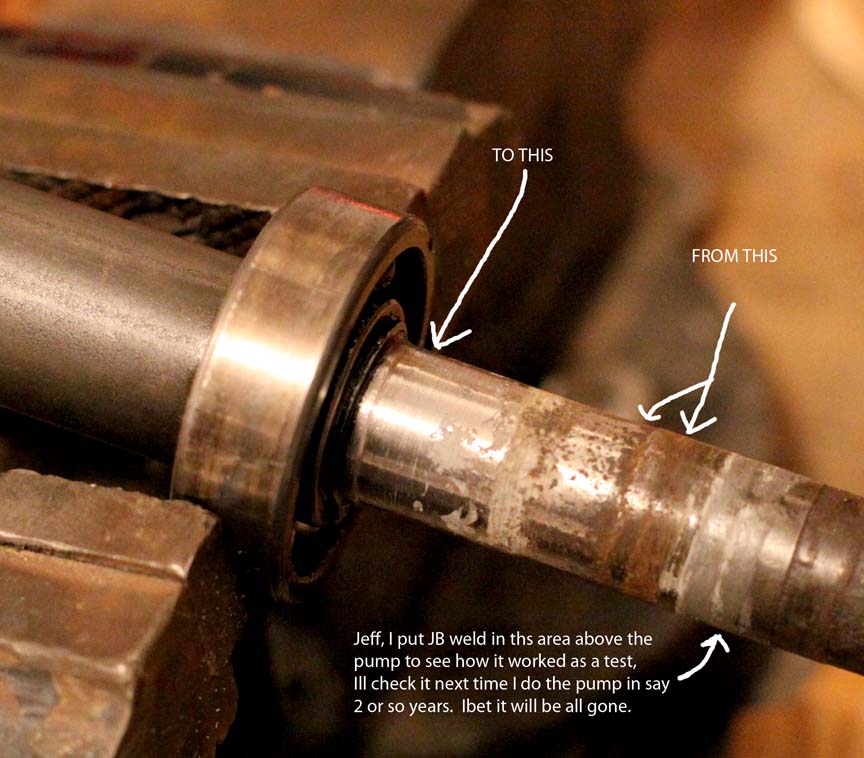

Here is a pic of the job.
Conrad

Nice work!, I wonder how the softer weld will hold up against the rubber seal on that, or the JB weld against the seal. Or is this portion of the shaft below the seals?

good test Conrad, Ive been wondering about this myself , Speedi-sleeves suggest you use a JB Weld like epoxy for deep grooves...Under the sleeve ofcourse, but I have wondered just how long it would really last
