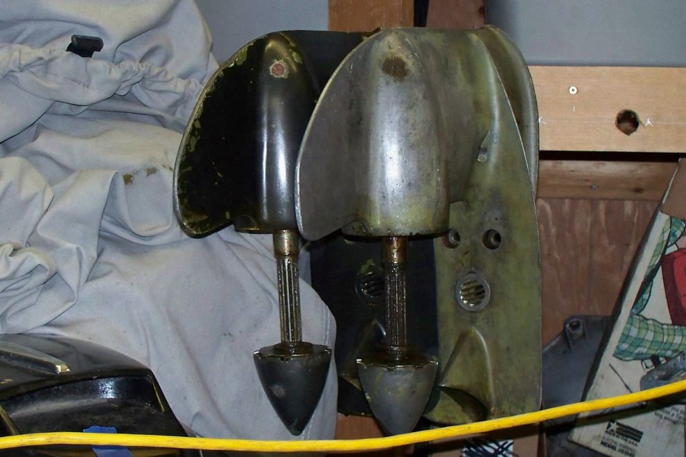

Re:Drive shaft info Mark78 15 years 6 months ago #30298
Joe,
If you discover that your lower unit is a mess inside - I have two real nice short shaft lower units for that Merc.
Write direct to me at frankenmerc at comcast dot net if you become interested in that solution.
Thom
