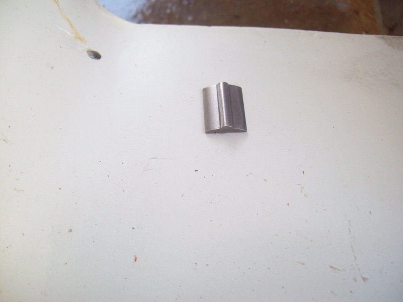

I'm live in my garage and just pulled L/U. The way the impeller looked I don't see how it can go both directions?? Also gear oil looks like caramel color I would say. Any input will be greatly appreciated. Joe
Just found this little jem on shaft seal under impeller. I know this can't be good!!!!
Re:HELP Mark78 L/U 15 years 6 months ago #30195
dont loose that, its the key for the water pump impeller

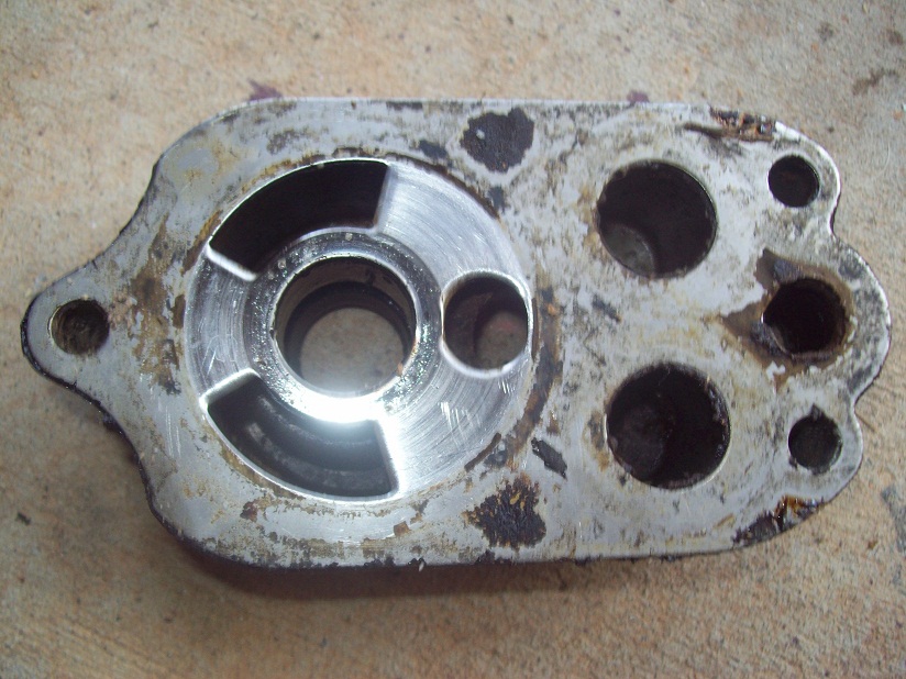

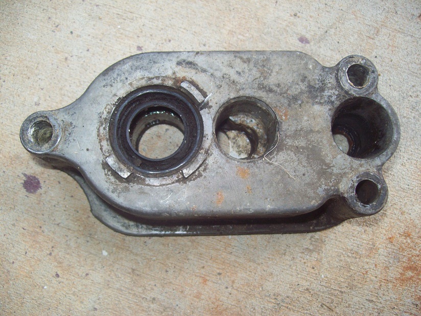

Re:HELP Mark78 L/U 15 years 6 months ago #30200
can we see a closeup of the water pump area
while the gearfoot is off, blow compressed air in the pee hole, water tube running up the tower, check for obstructions
look for the plug on the top of the block Conrad mentioned blow air backwards thru the block from that plub hole, again your checking for obstructions, old rubber impeller blade pieces possibly

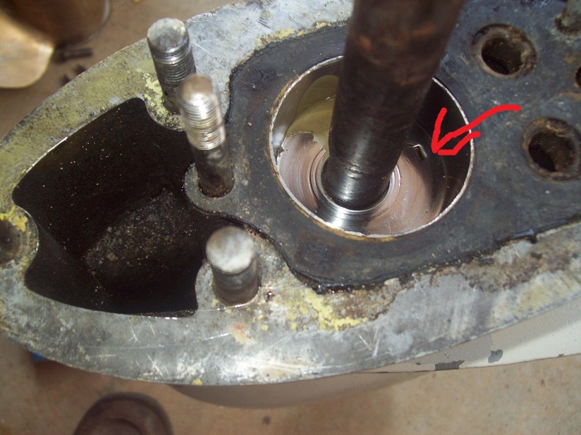

OK does that impeller key supposed to have a tab that fits into that slot in shaft cover? If so it's broken off.
Re:HELP Mark78 L/U 15 years 6 months ago #30202
the key is fine the flat side lays on the flat of the shaft, you clock your water pump impeller so the groove in the impeller lines up with the key and press it on

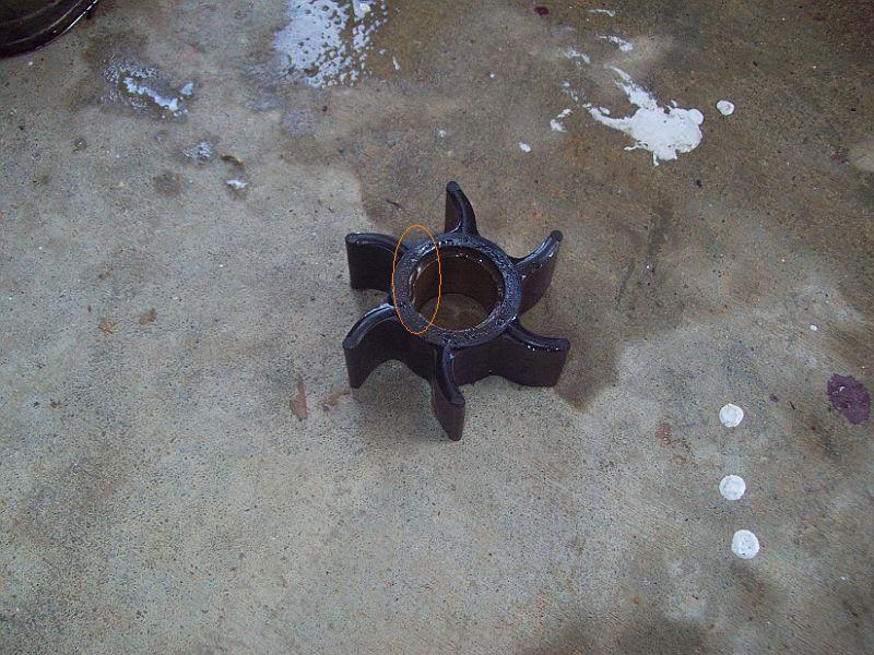

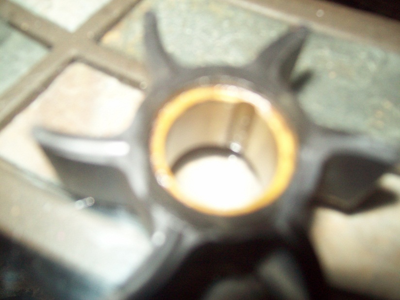

Close ups
The key doesn't have to go in the slot in the 3rd pic?

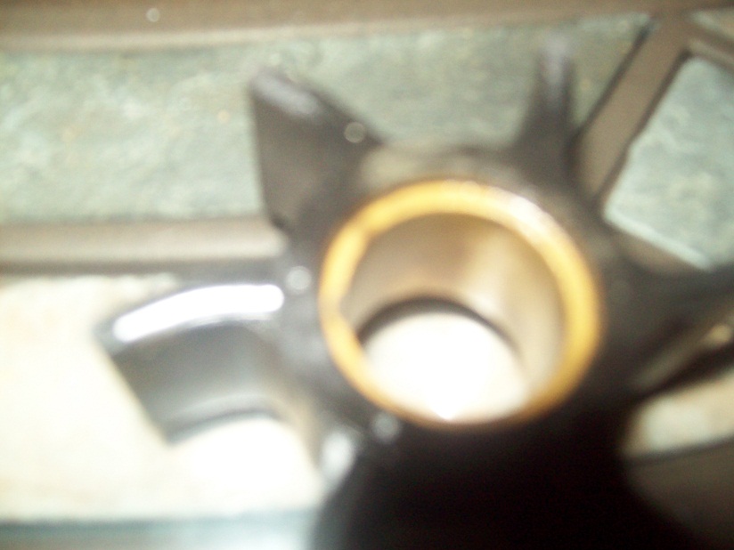

After enlarging this photo the area that I circled looks chewed up. Do you see a slot in that area where the key would locate the impeller? Looks like there is water in the LU judging by the color of the oil but maybe you knew that already.

The impeller doesn't look chewed up and yes the l/u oil looks like caramel. Joe

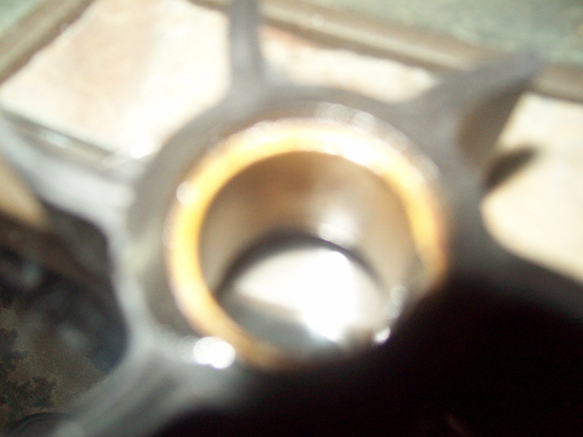

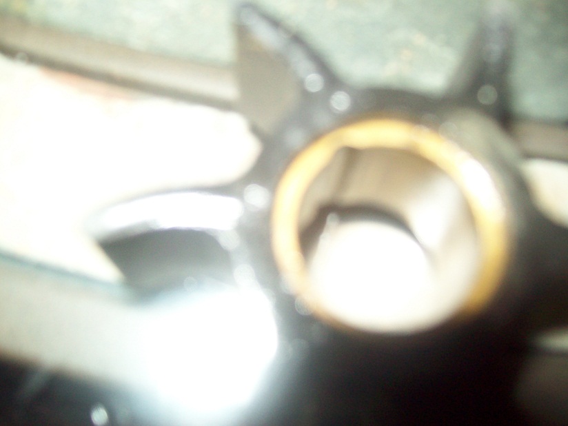

I wasn't referring to the rubber portion but the inner metal area that is in contact with the drive shaft. There should be a slot in that area that the nub on that key fits into.

That shows good in second pic. The inner sleeve isn't chewed up.

Yes, looks good.

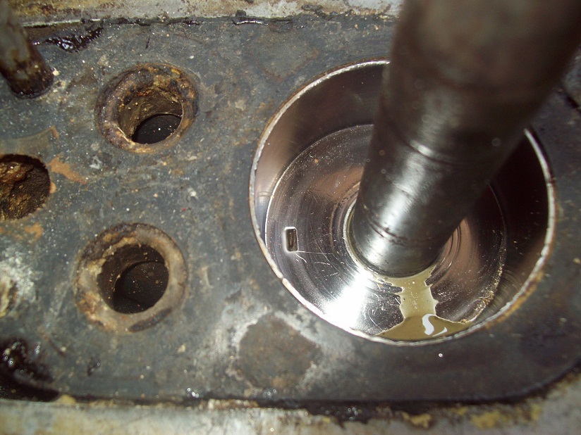

Is the key supposed to fit in this slot??
Re:HELP Mark78 L/U 15 years 6 months ago #30220
The impeller spins both ways !
The key does not fit where you think it does !
The key lays on the flat spot of the SHAFT and drives the impeller.
Where you are pointing with the arrow is not where the key goes.
Re:HELP Mark78 L/U 15 years 6 months ago #30221

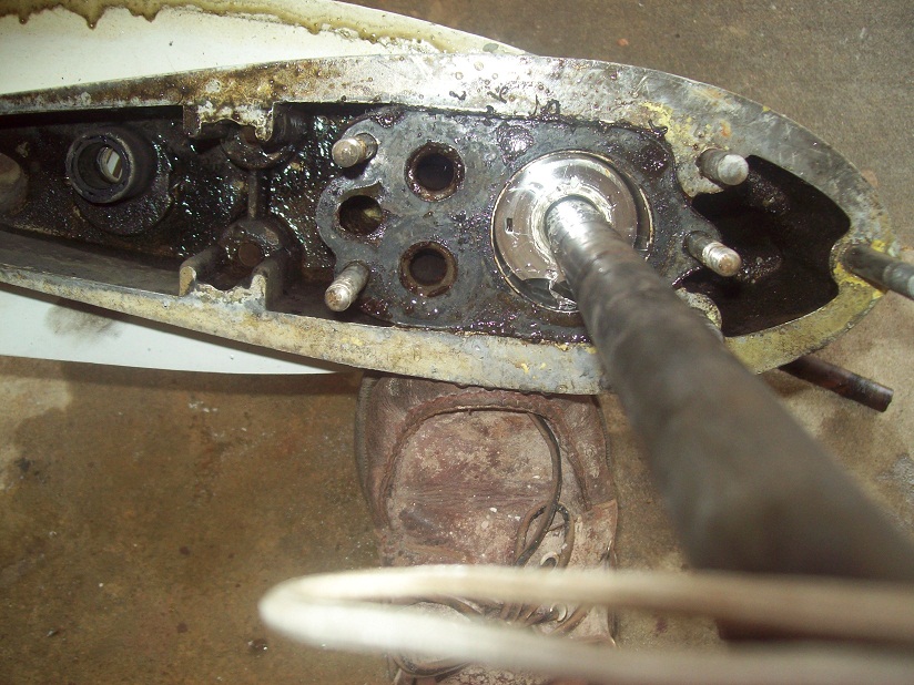

Joe, if you found the key in the shaft seal, it came out like I said. You've got water in your oil. My bet is the upper bearing and seal are done. The driveshaft probably dropped down and the key came out. The key goes in the "flat" spot on the shaft and the key dimple goes in the groove on the brass inner bushing of the impeller. A complete tear down is in order here!!! Don't mess around, and do it right. You did say you had clunking, clanging in the lower unit.......that tells be somethin' is goin' on in there, and it's not good.......

It might be me but the driveshaft looks like it is worn down in the area of the impeller and if so the key might slip in the impeller.could be wrong.
