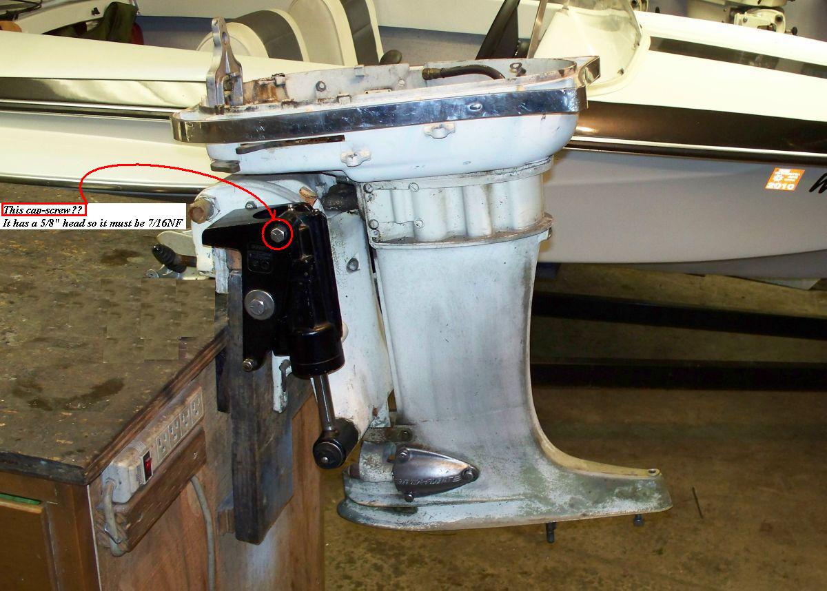

Two stupid trim questions:
The hole in the top of the cylinders that mounts to the bracket is 7/16 right? Seems a bit loose, but 1/2 just doesn't go. Just want to make sure I'm not missin sumpin.

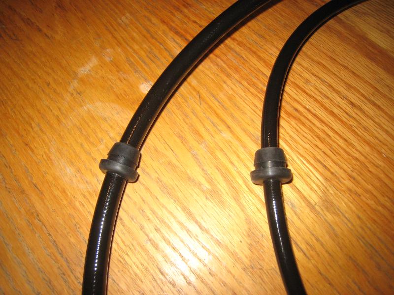

How does one move the grommets on new trim hoses without screwing the grommets and/or the trim hoses up. Between arthritic hands and a bad back, I'm in a quandary here!

Fogging oil or something similar will help slide those gromlets along the hoses & will also aid in installing them in the metal boot in the splash well.

Re:Stupid trim questions 16 years 7 months ago #3075
Frank,
See the attached picture.
I think I'm following you now & the picture holds the answer.

I figured seeing I hadn't heard from anybody I was just going with 7/16 anyways Doc. I was just checking to be sure, as it's a bit loose, but I would have to drill out more than paint to get 1/2" in. 7/16 just seems odd. Even so, I have a bunch of 7/16 stuff, but of course, nothing 4"!
I'm going to see if I can get enough plain steel stuff today to mount all the cylinders & brackets. All this fine threaded 1/2" stuff may be hard to find on the weekend. I got a buddy who works at an industrial supply here I get all my stainless from. I'll call tomorrow and see how I make out. Otherwise I'll order off the net.

First of all to answer Frank's statement regarding the 7/16" and extra slop in the related holes. The rams and brackets get worn over time. It shouldn't really bother anthing to leave 'em sloppy, but you certainly can drill everything out to 1/2".
Just make sure to use the correct length cab-screws and the short nyloc nuts so that they will clear the swivel housing as you trim up the motor.
You may also need to trim off the extension on the tilt locks if they are the original manual type or they will catch on the aforementioned nyloc nut.

I ordered all the hardware today from a buddy who works at an industrial supply. They have about anything in stainless you could possibly imagine (well, maybe not some weird merc stuff...). I'm not gonna drill the brackets out - the cylinders are right on 7/16.
I took the little end swivel piece out of the tilt lock pin, installed it at the bottom, and put a stainless washer on it with a small cotter pin through the hole the pin was in that held that little end swivel piece. Should work, or I can cut it off.
