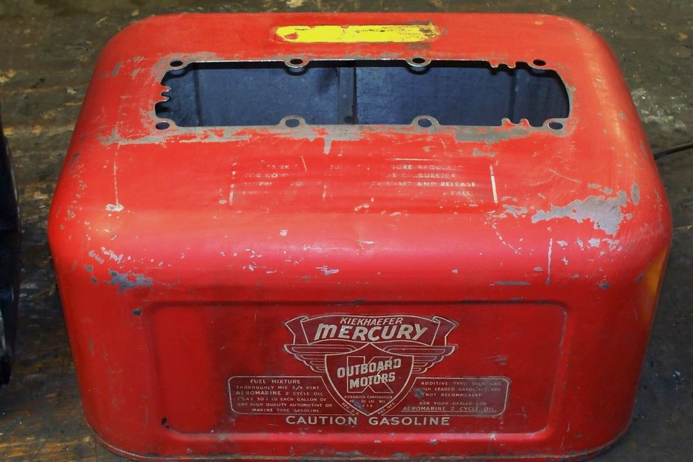

1) Does anyone have a good picture of the yellow decal on the 20H gas tank?
I don't see where nymarine has this specific decal and I'm hoping to get enough information to have him duplicate an original for me.

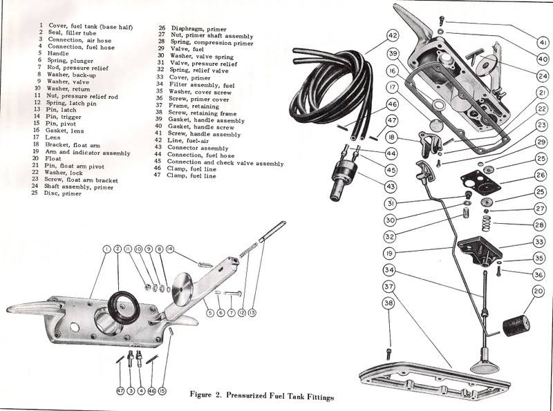

Heres a schematic, if you don't have one already..

I asked & got your answers Doc
The yellow decal was a dealer sticker
the color is the same on all the Merc tanks.
Dupli-color engine enamel #DE1605 Ford red. Also use the clear coat #DE1636
www.nymarine.ca/MERCGTANK.html for decals.
www.nymarine.ca/fueltankparts.htm diaphrams and gaskets

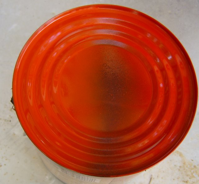

Messed around today Thom, paint. Like said on the "1605 Ford Red", seems too .."red". And I know I can never do the paint original, decades ago old metal Pressurized tanks. And like said, what new color to yer eyes from then new, is not many remembered anyway, years in the sun, the tanks we see now. Remember that Merc tank I gave ya, the "yellow one"? Asked when the heck did Mercs do yellow tanks? You slapped me upside the head, and said.."its FADED from the sun! dumbass! HA! :lol:
Anyway, heres a pic, a bottom of a coffee can painted today. Did both Ford Red 1605, and Dupli-color Engine paint too..Chev Orange. Its a DE 1607 Chev. Orange. The left side is the Chev paint, right side Ford red. the 1607, has some that classic "faded orange", but again, I'm not a "restore to perfection type"..just like stuff that looks good, and works, and runs.
Anyway, Thom, getting more stuff the .."care package", bring what mentioned, you decide. Heading you soon. BS then. Be well all..start saving up extra bucks for gas, forget the paint! Robby
