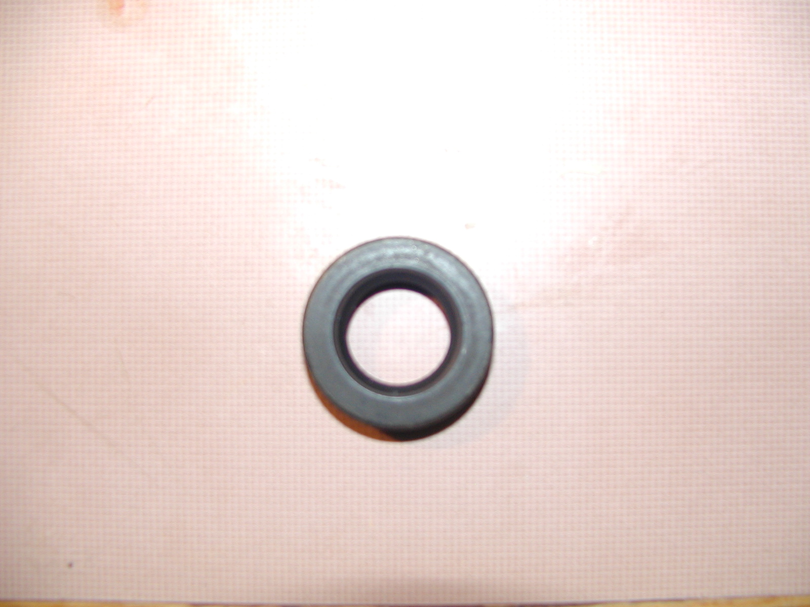

hi, i am installing prop shaft seals on my 1968 50hp lower unit. the book says to install with the lip side facing down on the first seal then the lip side up on the second seal. in the picture of the seal is this the lip side of the seal?
thanks
Re:stupid question 15 years 6 months ago #29768
yes
lip facing in prevents the oil from leaking out and the lip facing out prevents water going in
Great question!! you dont want the seals backwards
Re:stupid question 15 years 6 months ago #29775
In your pic Propnut, it looks like the lip is facing up. ;) (It's hard for these old eyes to see the detail on the inside of the seal.)

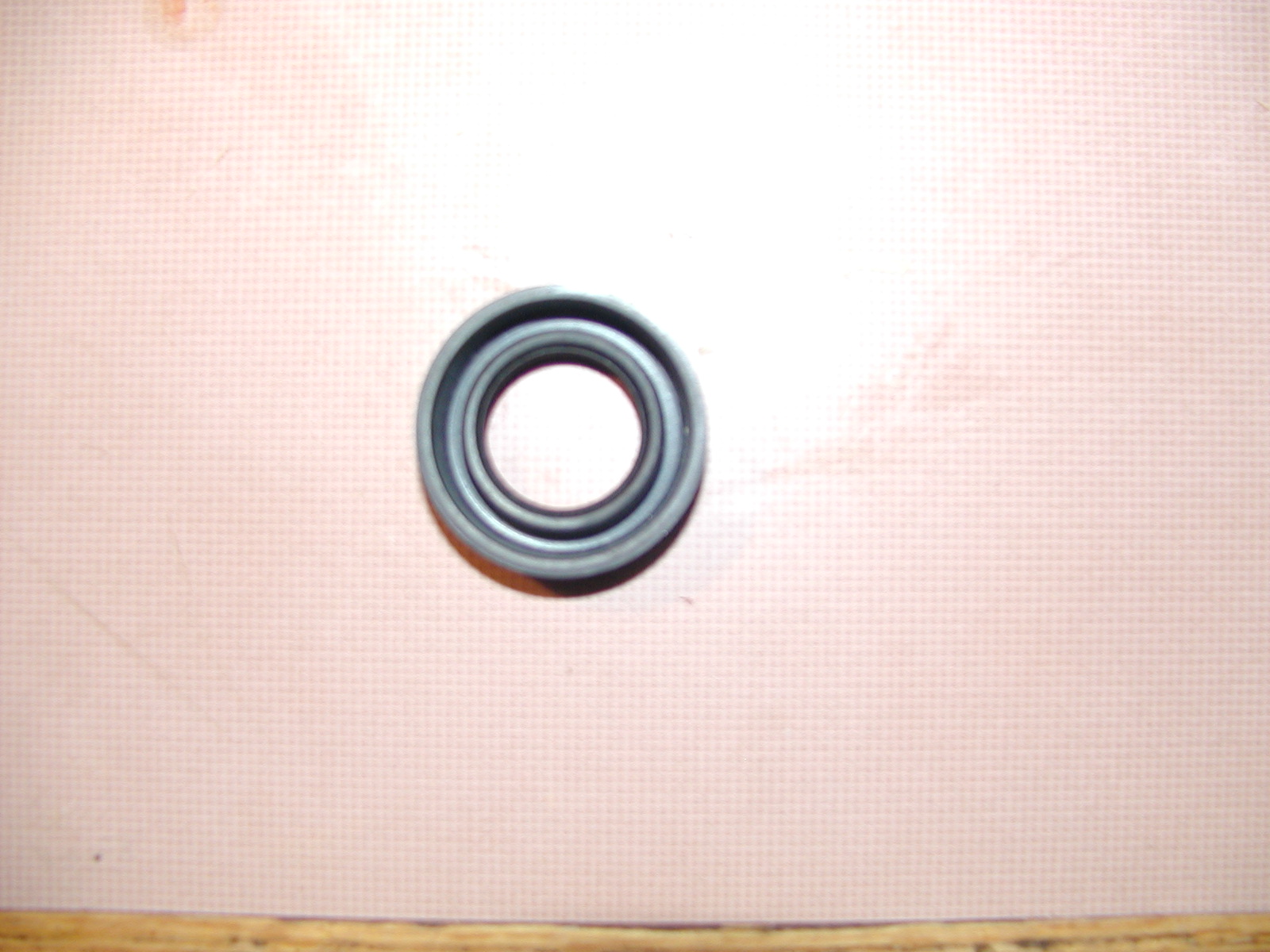

thanks madprops,i just wanted to be sure. mark here is a picture of the other side of the seal as a comparison.
Re:stupid question 15 years 6 months ago #29786
yup, lip down now.
