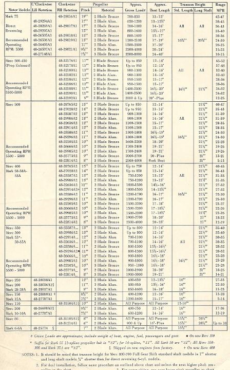

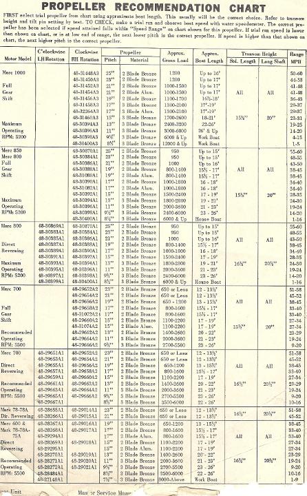

After looking all over the web tonight to see if a prop on ebay would fit my motor, I gave up. Down to the shop I go to look at my manuals. Nothing in the Glenn manual, nothing in the 65 and earlier manual, but I lucked out in the post-65 manual, and figured I'd share. :)

Frank i have a list of ####'s and what they are if you give me a ####### i can tell you if it fits.
