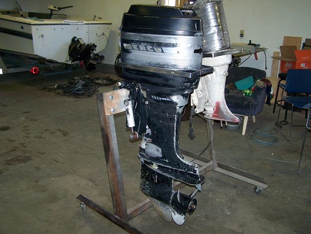

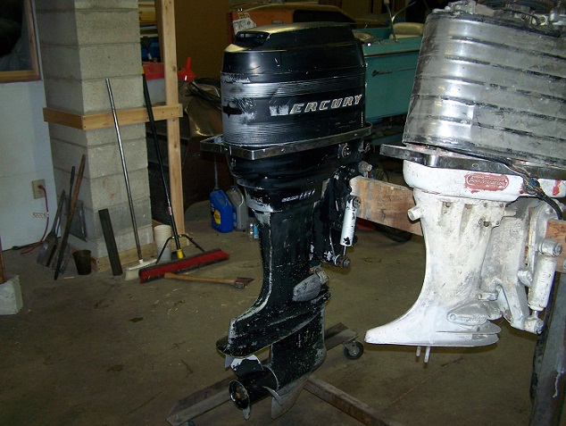

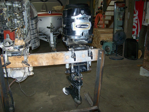

Got this one for the collection this weekend.
It was hiding, but I sniffed it out!
And here it is in the lineup.

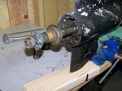

Well I got a chance to get to this gal this last weekend.
Compression says 1;120, 2;118, 3;125, 4;120.
The impellor was shot. Replaced it.
Gear lube was full and looked good, it may have been changed when they quit using this motor. I changed it.
The plugs looked new on the outside, when I took them out for the com. check, they were put in brand new. They had never been run.
Took the carbs apart and cleaned them.
When I took the prop off I found the thrust on backward. Just like it was on my 1000 when I got it. It was rusted solid to the shaft.
I had to destroy it getting it off. I replaced it and time for the test tank.
She fired right up and said "let's go to the lake". I explained that she was not leaving the shop looking like that. Uh oh I am talking to my motors!!
She pees water like it should and sounds pretty healthy. I think she's a keeper.
This is the pic of the lower on my 1000. This is how the thrust was on this 650.(No pic of it)
