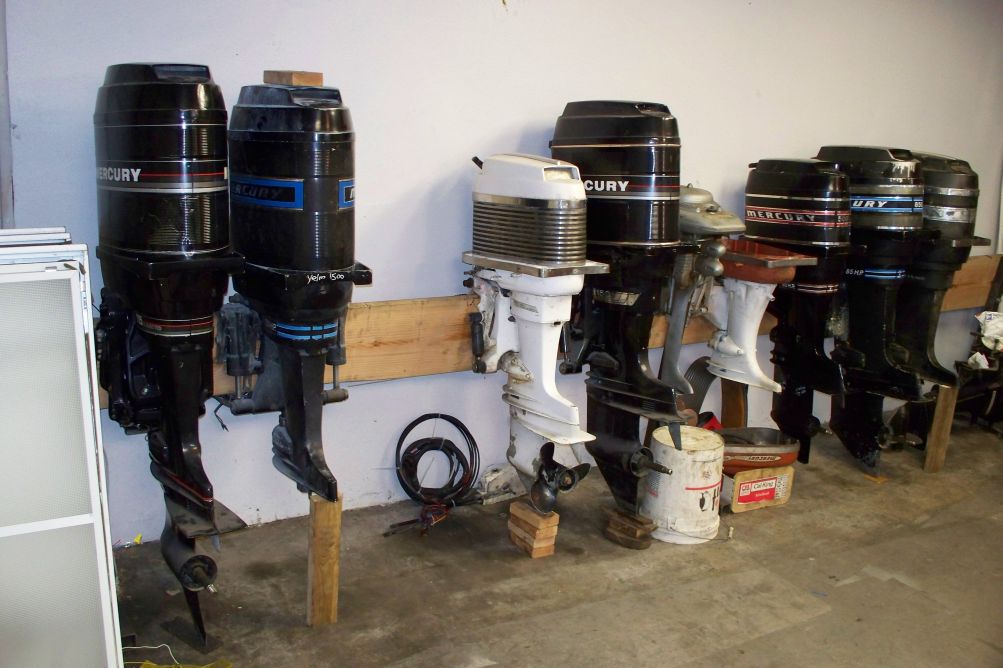

The secret to swapping your '66 500 powerhead onto some other year and vintage will require comparison of the power head to exhaust extension plate (EEP) gasket and either purchasing a shorty mid-housing (drive shaft housing DSH) and it's mating lower unit (L/U).
Having said that, you can use a 650 3 cyl shorty DSH & L/U, or a 70 3 cyl DSH & L/U, or a 500, 50, or classic fifty (45hp) DSH & L/U set-up.
You CAN NOT simply buy a later model 500, 650-3, etc L/U and bolt it up to a '66 500 shorty DSH, or some of the other parts combinations suggested.
The reason is that not too long ofter '66 (not sure exactly when) the bolt pattern (specifically the front starboard and front port studs) were moved creating the need to buy a matching DSH & L/U to avoid nightmares.
I've heard of folks 'egging' out the respective holes for these two studs, but I will not recommend that simply because it puts the driveshaft and crankshaft lower main bearing at risk of misalignment. (voice of experience here)
Note too that the gear ratio in the 650-3 and 700-3 will be different from the original 500 gear ratio and might require prop itch change.
Note too that there were a variety of propshaft sizes and spline counts in these various motors that would require a prop from their parts break-down - not one from a 500.
Having said all that - I have a sweet little '68? Merc 500 mounted on a '77 650-3 DSH with a '77 500 short shaft lower unit bolted up. (see attached photo of the little 'red stripe' 500)
It makes a much nicer set-up simply because the '77 has stainless shafts that will not pit from rust or corrosion like your vintage original 500's steel shafts.
Earlier model stuff - (pre-'65ish) may require replacing your exhaust extension plate (EEP) with the earlier lower pan with built in EEP or some other not-so-easy conversions.
