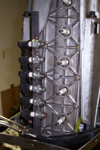

Have you inspected the distributor cap - to see if the spring loaded center carbon is intact?
Have you tested to see how far the spark will jump at the spark plugs?
In saying this - understand that you will need to give the spark a place to jump to to avoid stress on the system, but the spark should jump close to a 1/2" at the sparkplug end of the wire.
If it won't, but you're seeing spark on all (6) with short gap tests - consider the coil or wire connections.

Timing light can be used to check for spark on all 6

Absent a DVA meter you 'can' do 'some' troubleshooting by swapping coil wires around - obviously while the engine is made safe and is not going to start. (remove the spark plugs and control their spark to ground to avoid creating greater ignition problems than you already have)
Example:
#1 sparkplug wire has no spark.
#2 sparkplug wire has spark.
Move the small primarily green wire from #1 coil down to #2 coil and vise-versa with the #2 primarily green wire.
If #1 now has spark & #2 no longer will spark you have successfully eliminate the (2) coils from the cause of failure.
If you review your wiring diagram you can identify what cylinder's coil - via the switchbox - has the same color coded trigger wire in the other switchbox.
I don't have a manual in front of me so let's say #5 coil when traced back to the opposite switchbox that coil #1 goes to has the same color coded trigger wire.
Once the other switchbox's coil is identified that uses the same color coded trigger wire as #1 coil (which doesn't have spark when properly wired) you will want to test for spark on that coil.
We're assuming it is #5 in this exercise.
IF #5 does NOT have spark, and you then swap its small primarily green wire to another coil and vise-versa and can conclude the #5 coil is okay,...You have determined that the trigger wires (colored coded identical for #1 & #5 in this exercise) are dead and consequently you will need to replace the trigger.
If #1 has no spark, but its common partner based on color coded trigger wires has spark,...You have eliminated the trigger as the problem on #1 as well as #1's coil - - leaving the switchbox #1 uses as the culprit needing replacement.
