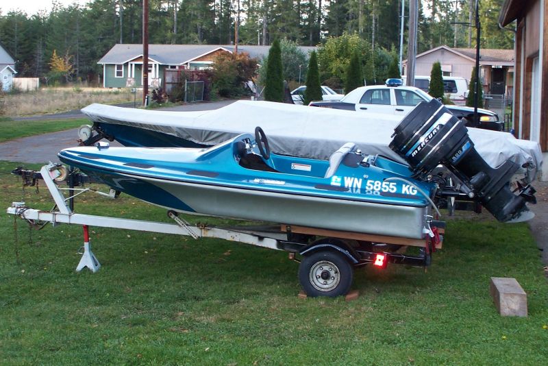

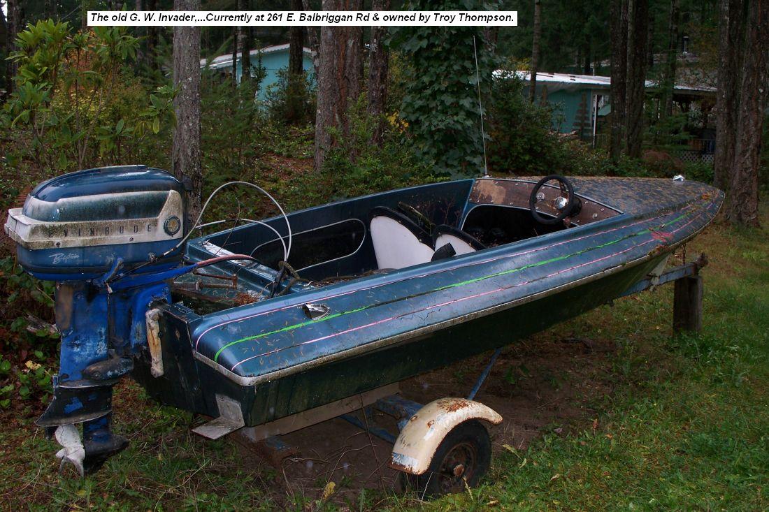

I'm not sure if either motor mentioned has enough HP to carry the bow on the GW Invader - if it is like the one in the attached picture with an old Evinrude hanging off the transom.
But,...If it is like the smaller GW Invader - like the other one shown with a 50 hp Merc - either the 650-4 or 70-3 would be O'Plenty of HP.
Thom

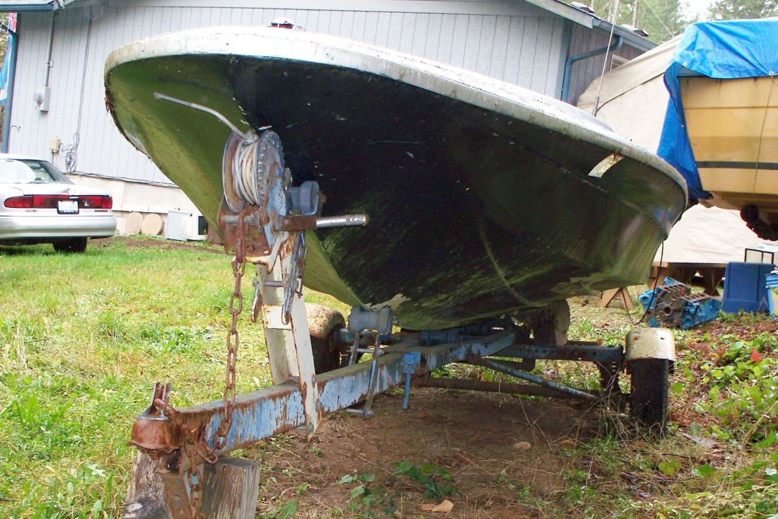

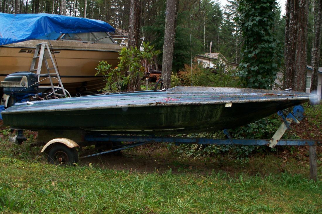

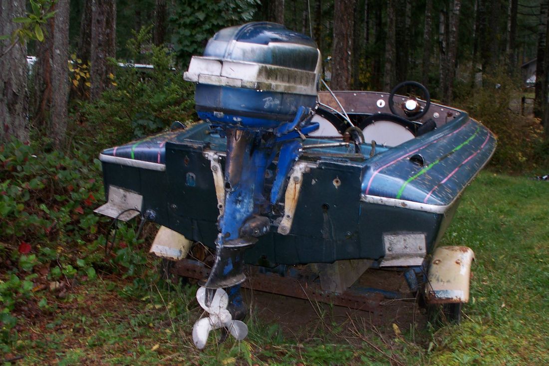

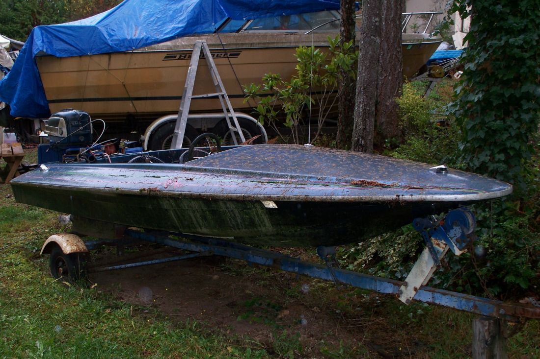

Dr Frank... what do you know about that top boat??? Ive been looking for someone that actualy knows about them, Ive only found 1 other online and it was an old sale ad. The guy I got the boat off, had a 70hp on it and claimed it was scary fast. If neither motor will work, I will look for something higher powered.

Jetboat,
I had this one when I was a young kid an didn't have the knowledge or skills required to identify and correct this hull so it would stop prancing.
I had over 200 lbs of sand in the bow and an ugly howling v4 65 hp on it.
If I had it today I would identify why she romped so I could throw away the sand bag and run a minimum of 80 hp - probably as much as a healthy 1150.
She had a lot more boat (weight due to hull design) fore of the helm and narrowed back to a quite narrow transom.
In some respects she has some similarity to a small Allison or Viper and I believe that if the bottom of the hull was trued up in the right way and she had enough HP you could carry the bow and really fly.
Before I sold mine I put a Mark 25 Merc (20hp) on it and turned the kids loose.
It was perfect for them. It ran about 22 mph on plane with no romping, etc.
I had lost track of it for years, but my nephew spotted her dying in a back yard and recognized the paint job.
I approached the current owner, but it wasn't for sale.
Thom
