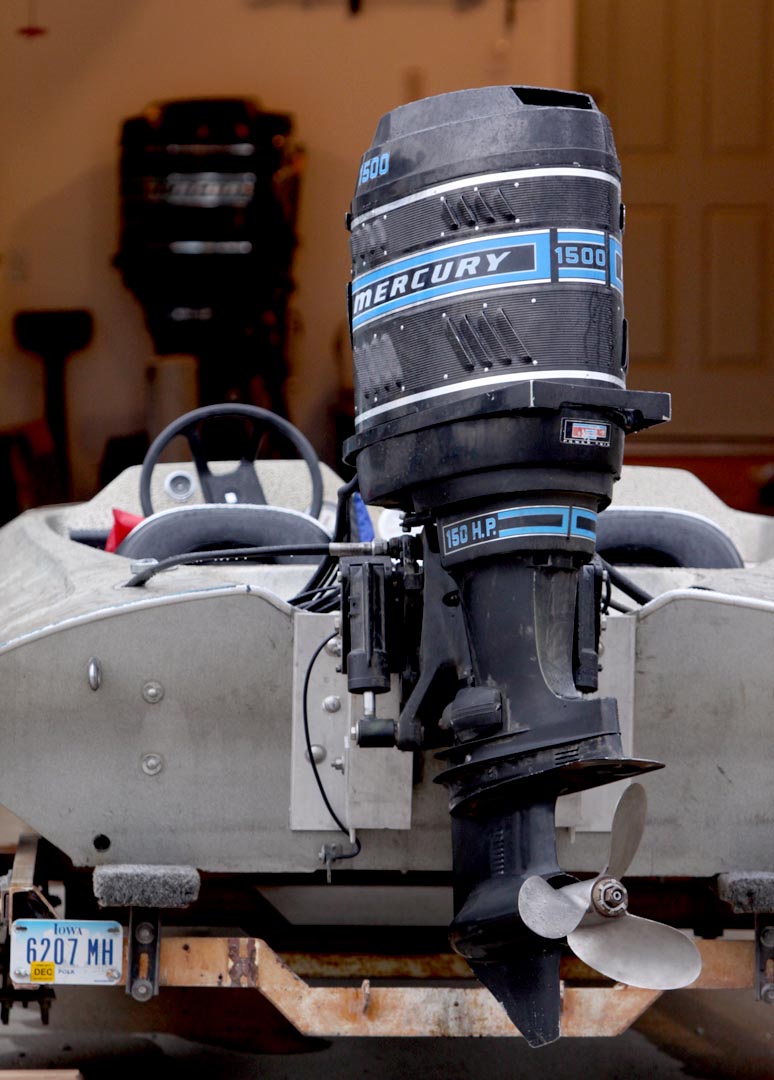

Well last few days I have worked on the Carlson Contender and 1500 Short Shaft combo. Put a 12 gallon fixed Moeller tank in, put a small turn fin on, hooked up a tach, water pressure gauge and beefed up my jack plate with 2 more bolts thru the transom and aluminum angle to help support the transom.
Today I took it to the river and tested a 23, 24, 26 chopper and a 25 cleaver.
The motor ran up to nearly 7000 RPM before I pulled it down. It seemed to run right up to 7000 if needed but I feel it was at its peek HP around 6200.
This is the same as an xs block.
I got a 70.9 MPH reading on the GPS but the current messes with that so hard to tell real MPH. Id guess 69mph.
The choppers worked fine except I did not feel as comfortable at speed with them, the boat did not stay as stable as I would like. And man the TORQUE steer is quite brutal with the 26 chopper. At speed I have a tough time moving the steering wheel off the lock. So when I starts chinewalking a bit its nearly impossible to correct with out over compensating.
The cleaver ran out well just like it always does. Turbine smooth and the boat feels much more stable I ran out of gas before I could do a full throttle pass with my 25 and 26 cleavers. But I imagine they would have put up bigger numbers than the choppers because thats what they have done in the past.
Man 12 gallons is gone quick at 6500 RPM
PS the small turn fin(ski fin) helped, but it needs to be bigger.
I think this rig will produce 75 mph this summer after I raise the motor a bit and put on a trick lower unit that I put together. (Right Dr. Frankenmerc :)
Conrad

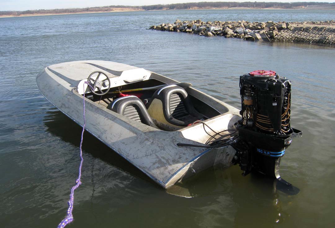

A pic or two more from today.
Conrad
