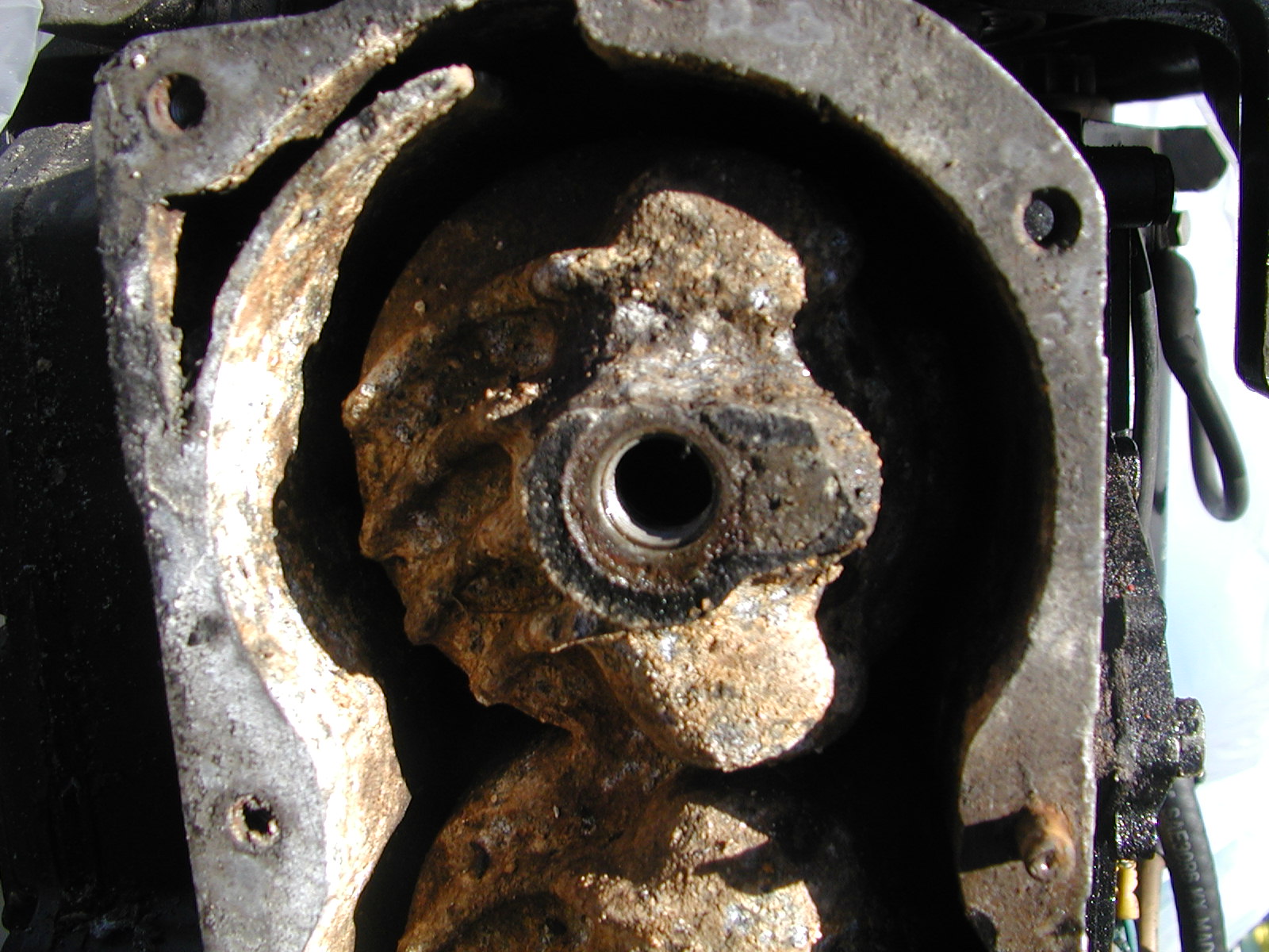

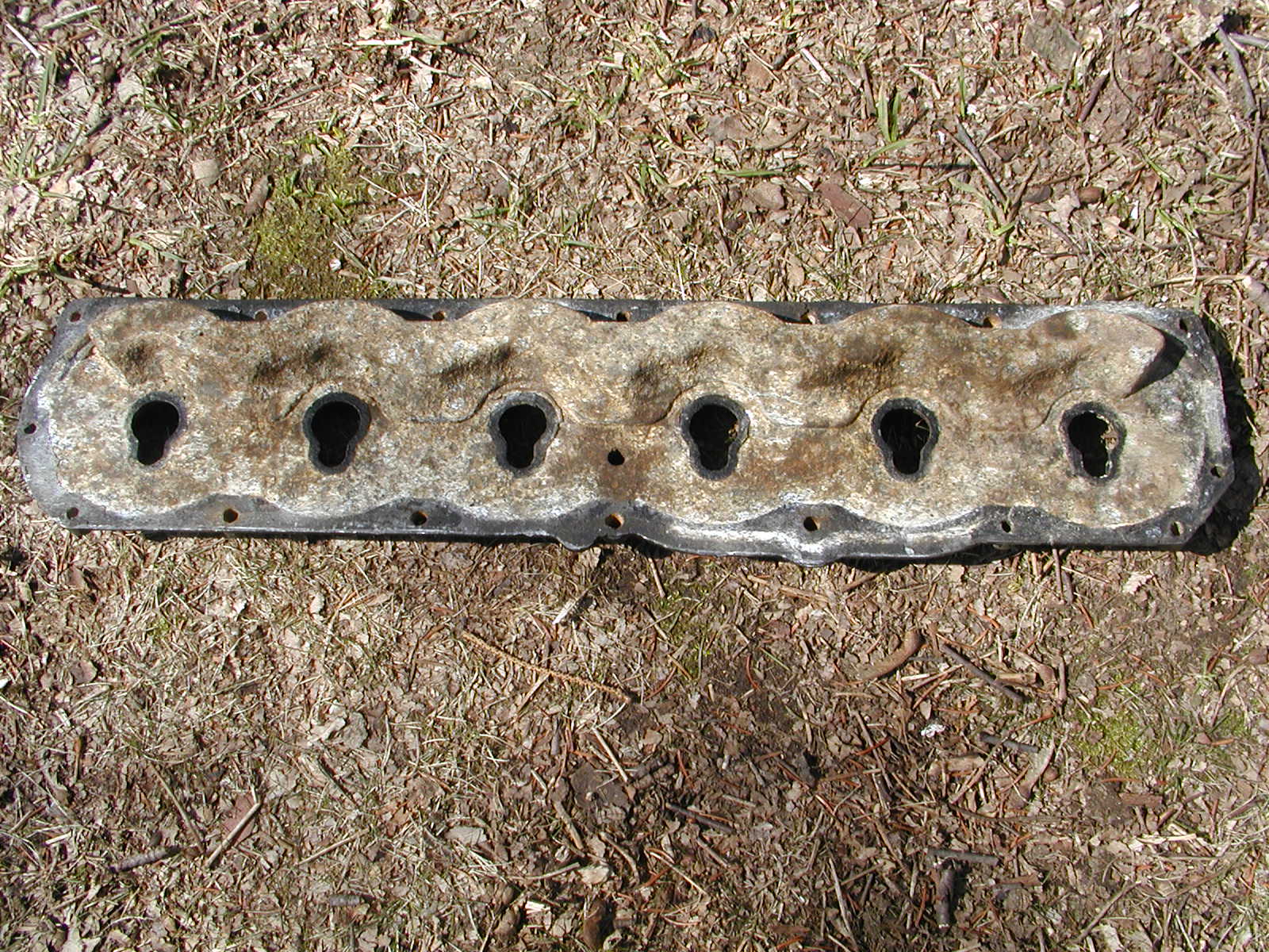

i did manage to remove the cover, unfortunately the mating surface on the #1 and #6 piston seems to corroded to make a good seal.

Your situation is certainly not ideal. Permatex make an epoxy suited for extreme water environments (it is not the standard white permatex in the red box) that I used on a repair for a merc 900 I had to replace the gasket on. The corroded area was not as bad as yours but I got it to work. Clean the metal real well as best you can. Build it up and let it dry then ad some more. Finally I took some real stiff cardboard and backed it with wax paper so the epoxy would not stick. I cut out holes for the spark plugs and used the card board to make the final mating surface. Once dried and hard I had to do some finesse work careful not to get any debris into the cylinder (leave the plug in place if you can) it worked and is still working. Do not build up the permatex to the point you are clogging off other areas of the cooling chamber just focus on the areas that require attention.
Of course the guy used the boat and motor for fishing so it was not the ultimate restore job. Motor still runs well and the repair as I said is still holding. I did take photos of the job I will have to look and see if I still have them.
Tim Calmes or Doc Frankenmerc may have a better solution for the problem but the above explanation right or wrong is how I handled it with decent results. Anything to keep a good motor running!

I cant imagine that your cover is any better than the block as far as corrosion goes. If you are able to mill the surface you could bond a washer of the appropriate size to the milled surface in order to bring the level back up to spec. The water jacket is not under any appreciable pressure so the washer just needs to be bonded with a high temp epoxy. Once assembled nothing can go anywhere as the plug is through the washer. You would have to ensure that you replaced what you removed with the same thickness washer or the plate will never seal.

Replacing the cover may be an option over fixing the old one if it is in need of major repairs.

I probably have a good used replacement for your top cover if needed.
I try and keep any covers and plates that are still good simply because so many of them for various Mercs have gone NLA.
I have (6) huge bins full of various plates and water-jacket covers.
Please write direct if interested.
write to: frankenmerc at comcast dot net
I have successfully welded new aluminum around spark plug holes to create a good surface for the top cover to seal against.
The trick is to grind off all the dirty aluminum, using a dremel or die grinder, working until there is absolutely no trace of corrosion or dark aluminum within a 1/2" of the area to be built up.
Then explain to your welder guy the importance of welding (TIG) very slowly to avoid the dangers the professor mentioned.
I tell the welder to weld in short welds - say 10 seconds MAX - and then waiting until the aluminum block has cooled back to below 100 degrees F, before doing another weld. Patience and heat control are a must.
Then once the welding has been completed you can use an aggressive file to get down close to the intended flat surface.
Then - if you're good - you can take the surface down to a finished flat surface - but I always surrender and allow a machine shop to finish the surface on their 'resurfacer' (drawing a blank for a name) commonly used to resurface a head off an automobile.
Be prepared to have to return to the welder if voids show up in the weld once the excess has been ground off, and then of course plan on returning to have the surface smoothed out again after the follow-up welding.
Once this repair is completed and you have a cover with good raised circles around each spark plug hole you'll be good to go for a long time.
Epoxy repairs rarely last very long in this corrosive environment IMHO. I've seen many failed attempts that just add to the mess needed to be removed to gain good clean aluminum to weld to.

the top cover is in pretty good shape even around the holes that were badly corroded on the cylinders. i have decided to go with the marine tex epoxy that jim had success with. at this point in time with my daughter starting college in the fall i am taking the budget approach. anyone have any suggestions for removing the old gasket material? they are stuck on there good.
