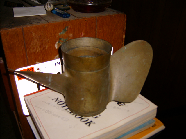

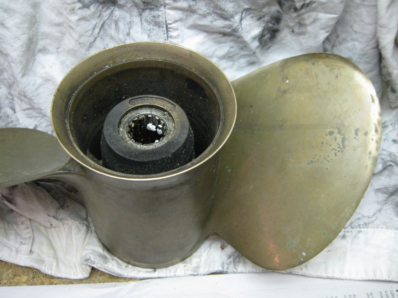

Purchased this prop on e-Bay. This one is used but in very good condition with some minor scratches that can be removed, and appears to have factory cupping, which was an option back then. Will sharpen the blades, remove the rough edges, and polish. Like finding an old rare coin. It is part number 48-49630 A3 13 3/4 x 21

Re:1970's Quicksilver 2-blade Bronze Prop 15 years 8 months ago #27320
Great looking prop for sure! Nothing better looking than a good bronze prop on the back. When I run my 1500 Ill tell you I get more comments from that 21 bronze I have all shined up that I purchased from you than I do with any stainless HP prop I have.
As far as factory cupping goes. I believe the A2/A4 numbers after serial numbers are what designated factory cupped props. Others can confirm this.

Conrad, you are right, the old Mercury prop charts say that Quicksilver Propellers are available in cupped form by substituting "A4" suffix in the part number for the "A1" and "A3".
www.maxrules.com/oldmercs/Propellers/Props/26.pdf
My prop reads "A3" at the end, meaning that the cupping was not added by the factory.
The prop will go on a light 1971 15' Glastron V-153 with a 1974 in-line 6 cylinder 115 HP Mercury (see my logo picture above). I have three other identical props like this one and they are fast props - GPS 52.9 MPH.

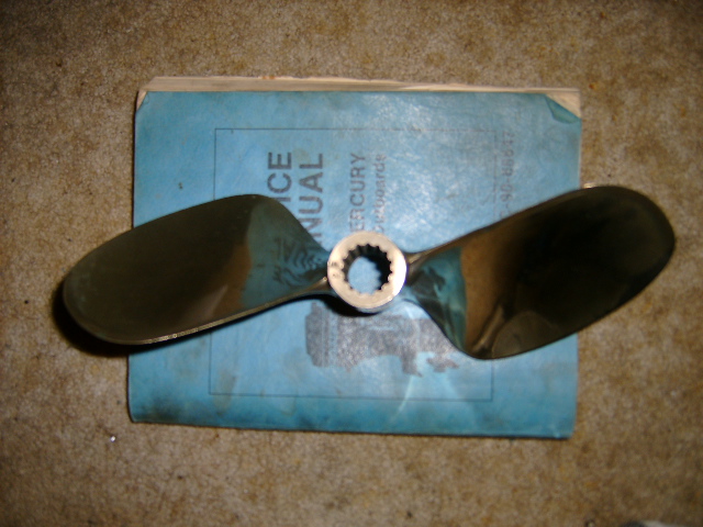

Re:1970's Quicksilver 2-blade Bronze Prop 15 years 7 months ago #27362

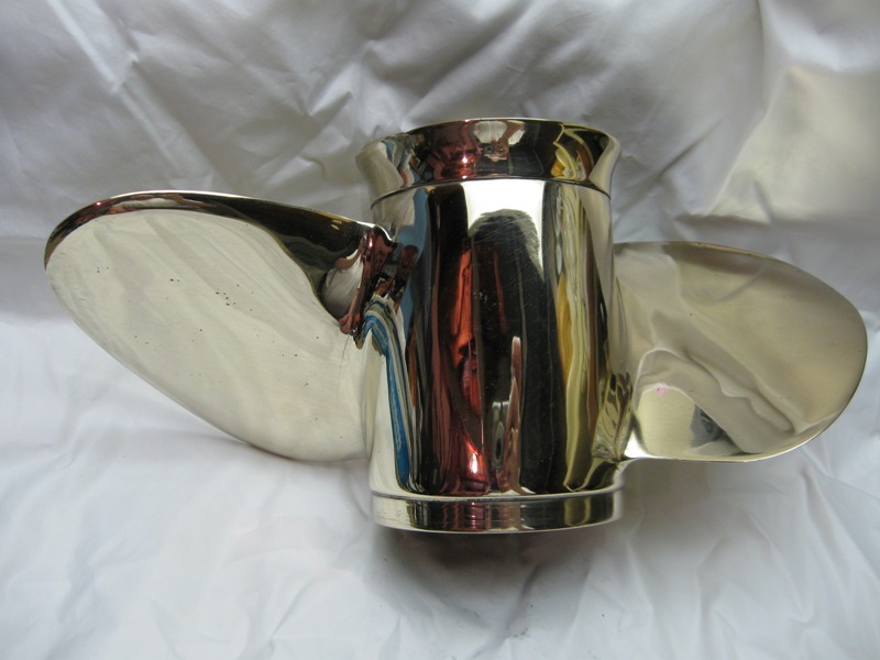

Just a hint of what this prop will look like when Dpanky is done with it; (The man does NICE work! ;) )

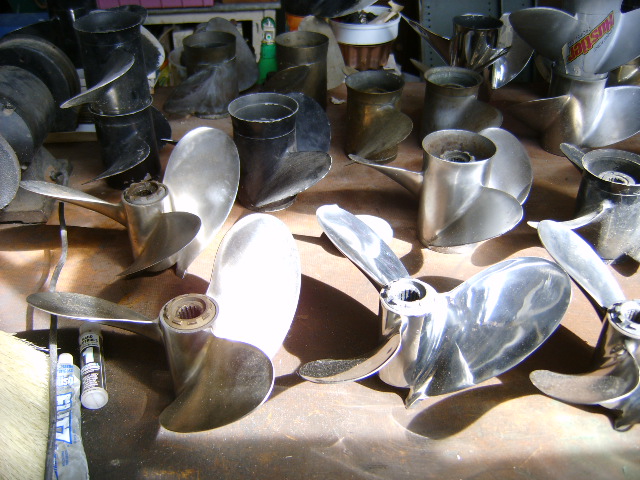

Re:1970's Quicksilver 2-blade Bronze Prop 15 years 7 months ago #28094
Love the bronze props.....I have pick'd a few myself. 48-49610 A4 through 49614 A4 witch translates to 13x20 through 14x24 with chopper style blades I will try to post a pic.

Re:1970's Quicksilver 2-blade Bronze Prop 15 years 7 months ago #28139

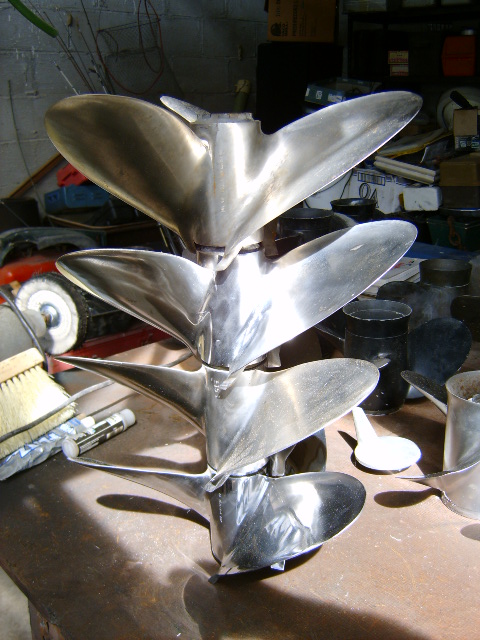

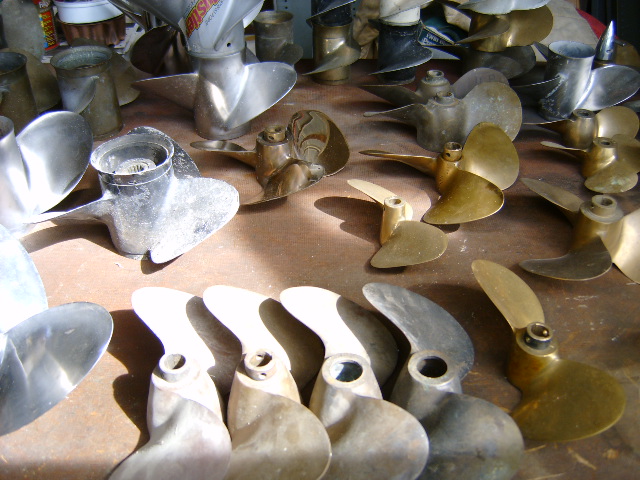

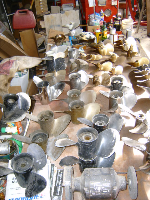

Gentlmen....I have a prop problem............
Re:1970's Quicksilver 2-blade Bronze Prop 15 years 7 months ago #28140
Believe it or not ....those are the ones just layin around.....lol, some I have trimmed and hammered into ....well spd props etc, Yes I am afraid to count them all. I do sell some times but not alot. some I shine up and others I set outside and let,em turn green........then I use them and see if there is a difference from dull to shiney, Not much difference by the way. The last 2 pics are all McCulloch props for my 75hp tripples.

Great collection. You should convert a whole wall of a house into a trophy room and display them on wooden shelves with labels as to make, diameter and pitch.
Do you repair props for a living?
Here I thought I had a problem owning 10 props.
Re:1970's Quicksilver 2-blade Bronze Prop 15 years 7 months ago #28143
Nope to the repair for a living. But maybe I missed my calling?..lol. At ten props youve just begun, I have around 125 not on a motor and I have 27 of those-9 boats and alot of stuff to keep me outa trouble?

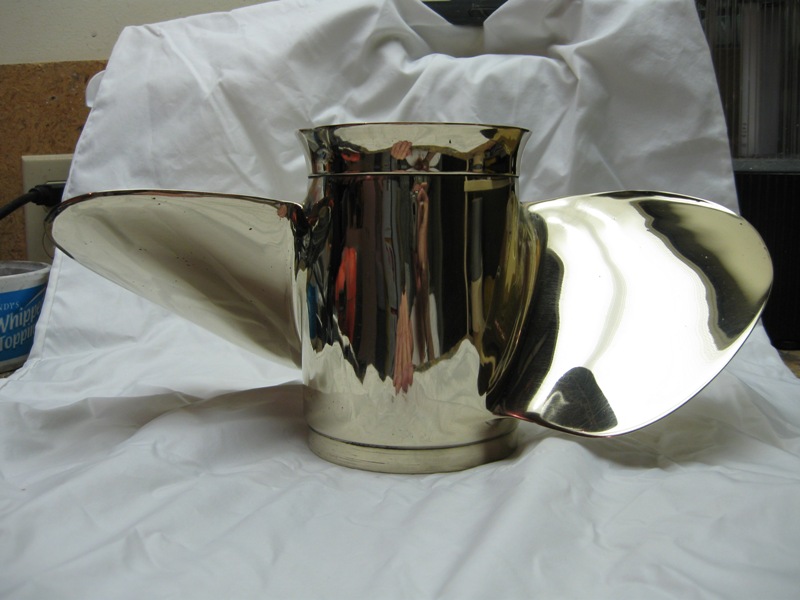

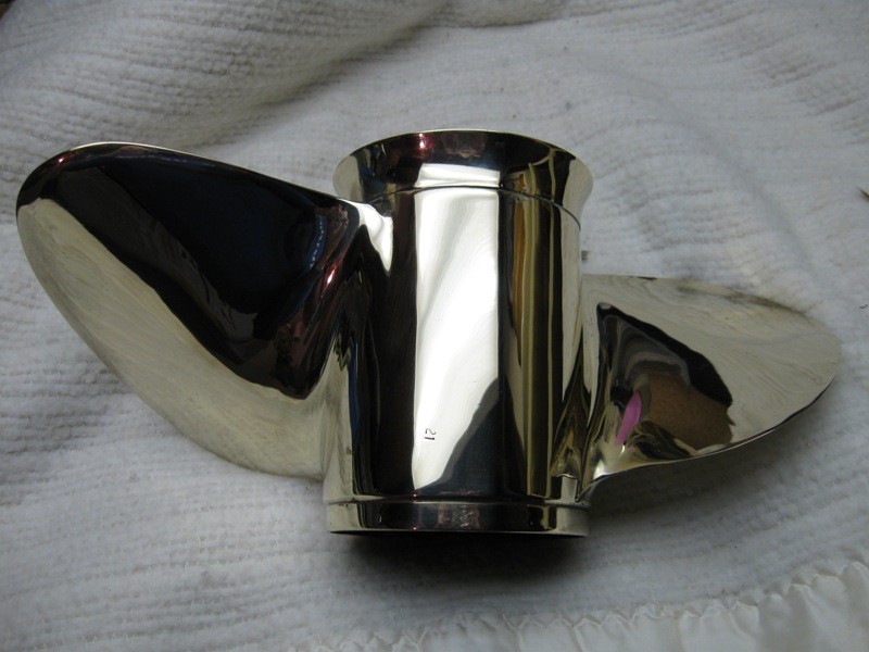

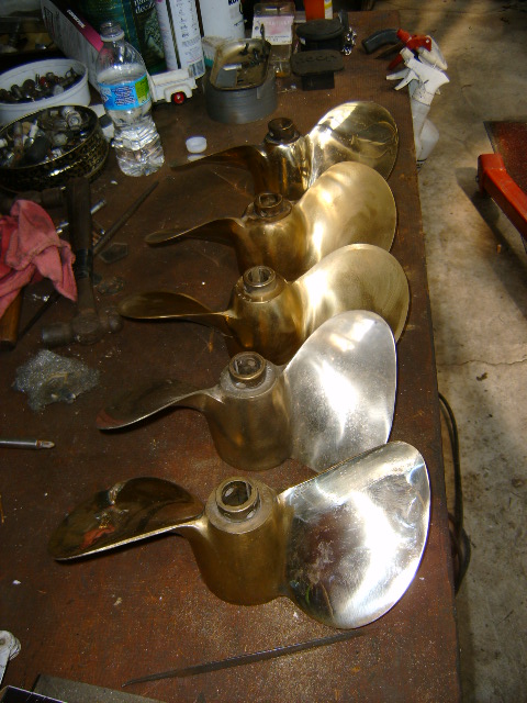

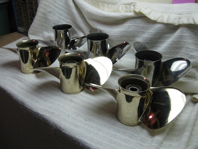

Just refinished this 23" pitch Mercury 2-blade bronze.
Re:1970's Quicksilver 2-blade Bronze Prop 15 years 7 months ago #28239
dpanky: Could you share you refinishing procedures. Your prop look wonderful.
Greg Anderson
Wisconsin
Re:1970's Quicksilver 2-blade Bronze Prop 15 years 7 months ago #28246
It is a simple matter of getting rid of " big " scratches and going to smaller scratches ,by using 400 wet / dry paper until you get to 2000 wet/ dry paper. Then go to a polishing compound. Various grades and materials are used in polishing compounds , including diamond.
Re:1970's Quicksilver 2-blade Bronze Prop 15 years 7 months ago #28271
I have used everything from a palm sander to a dremmel tool, I finaly bought a buffer from sears and it works very nice. I learned to re pitch and cup props for myself useing any thing I could find ending up with a 4lb pound brass hammer in a vice and a nice new brass hammer. It takes alot of time but I enjoy it.
I use several types of polish from the stick kind you can buy a Lowes, but my favorite finish grade is flitz. it comes in a tube and its a paste, It gives it a mirror finish.
dpanky are you in IL? Im 30 mi N of Indianapolis
Re:1970's Quicksilver 2-blade Bronze Prop 15 years 7 months ago #28276
  • dpanky
  • dpanky's Avatar Topic Author
  • Junior Boarder
  • Junior Boarder
  • Posts: 109
  • Karma: 11
To start, I use 120 grit sandpaper on a 4 1/2 inch disc pad attached to a drill to sharpened the blades, touch up imperfections, blend metal, and get out scratches. Make sure you keep the disc moving so as not to take too much metal from any one area. Then I use wet or dry sandpaper from sheets, folded into little sections, and sand by hand, using 220, 320, 400, 600, and possibly 1000 grit. At that point, a cotton buffing wheel attached to a drill can finish to a mirror like shine, using Mothers Mag & Aluminum Polish. Flitz is also good, but expensive. Then use the hands and the above polishes to finish the job. Try the Home Depot for a combination of stick grits and cotton wheels. Sand paper for 4 1/2 inch disc pads are hard to fine. 5 inch also work, or cut out the circle from sheets. Mothers Mag & Aluminum Polish can be found at car parts stores.
I live in St.Paul, Minnesota with a boating season from May to October.

Finished the e-bay purchased 21" 2-blade bronze prop. Had more scratches and imperfections hiding under the layer of tarnish than I thought. Took about 4 to 5 hours of labor, even with power discs and buffing wheel.

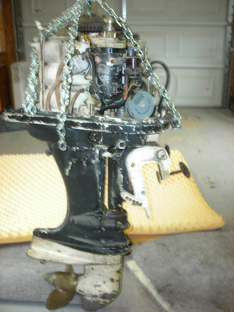

this is a very helpful thread for me,i just got a 1961 merc 450,with a great bronze prop,i couldnt tell you the pitch ,im going to restore the whole motor including the prop,the motor runs great thanks to tim c.

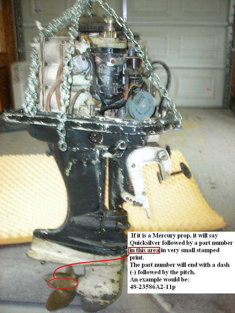

See the attached picture for where to find the prop's part number.
A little 600 wet-n-dry across the area and you'll be able to see the numbers.
