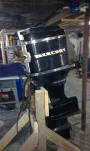

Thinking of buying a 1965 90HP. The issues are that the top two cylinders have low compression 30-40 lbs. (the other 4 are 120), It has a newer( later than 1965 unknown year) lower unit, and the controls are incomplete. I most likely would not be able to do the work myself should I buy this motor? Looks to have been used in fresh water fairly clean and turns over.

Went and looked at the motor. Did a compression check; the lower 5 cylinders were 130 plus. Top cylinder was 40; after spraying some defogger in spark plug hole and cranking over it came up to 80. Did not see any signs of over heating but who knows.
It is a short shaft with kit to make it a long shaft. Lower unit looks fairly new. Mid section has been spray painted over some corrosion. On mid section about midway up on starboard side is a hole about 1/4" wide and 1" long. The hole is at an angle and looks like under the new spray paint corrosion or heat or something was going on around the hole. Does not look like a factory hole more like something popped out or was drilled in, strange. The cover and wrap is in good condition with a few scratches.
It comes with two face plates, a brass three Blade propeller, cable set for this motor plus NOS cable set for 1966 motor($300. from old merc guy), controls w/key, two extra starters (one new one rebuilt), how to repair CD, owners manual. Home made stand.
All well under $200.
I need a long shaft not crazy about the looks of the conversion set up. Need to decide.
