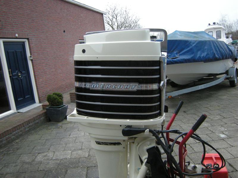

about a year ago i recieved great advise on this forum on restoring my 1963 Merc 850.
It is almost finished now and i think it looks good.
yesterday i tried to start it but nothing and after a few seconds a loud bang! oops! :ohmy: something wrong with the timing?
After i reversed the wires coming out of the distributer it started in a second and idled perfectly. I made mistake when i replaced the wires in the distributer.
This motor was used on salt water and was very hard to take apart,
i drilled out about 20 broken bolts.
i replaced a lot of parts: crankseals, upper and lower crank bearings,opend up the crankcase to replace the sealant, flywheel, distibuter cap, plug wires etc. etc.
now i am looking for a boat to use for a test ride
Ed from the Netherlands

Re:merc 850 start up 16 years 7 months ago #2659
Is the black circle on the cover the waterpump indicator???
Re:merc 850 start up 16 years 7 months ago #2660
yes,
it was already there, and i didn't want a large hole in the cover.
I know it is not necessary on this model.
Ed

Re:merc 850 start up 16 years 7 months ago #2665
Boy Ed, running great. Good for you. Thanks for the video.
I'm about to install a water tube out of the top of my '63 1000 as well, but not sure where I am going to put the discharge (high or low).
Frank
Re:merc 850 start up 16 years 7 months ago #2667
it sounds the same as yours Frank.
I would install it in the lower cowl just because it looks better.
