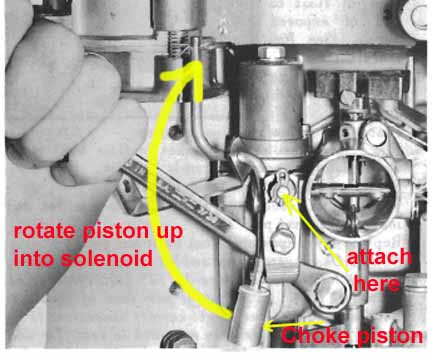

the choke rod runs up thru a hole in the top cowl with a choke rod knob for manual operation
for auto choke...bolted up inside the top cowl is a solenoid in which a piston plunger will retract to close the chokes
the piston attaches to the choke rod assembly by a cable , rotate the piston around facing up into the solenoid once the top cowl is on
your going to need that "choke rod assembly with piston" , assuming the solenoid is still in the top cowl
choke wire from solenoid to internal wiring harness is blue

That confirms my suspicion that it could be an electrically operated choke. There is no solenoid or choke piston evident. I don't believe there is a hole in the top cowl for a rod and knob, but that would be the easiest solution - especially since I will be selling the motor.
I won't just drill a hole in the cowl if it's not there. I think this motor is in pretty good shape for an unrestored example of the marque. Just think - it was manufactured only a year after I graduated from high school!
I'll have to take another look at the top cowl to be sure there isn't something like a hole and grommet in it. Do you happen to have a picture showing the manual choke knob?
