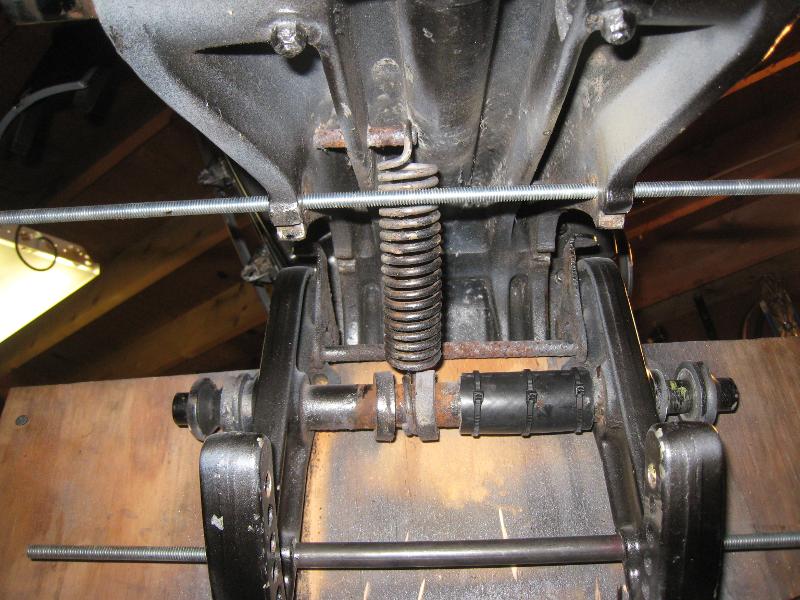

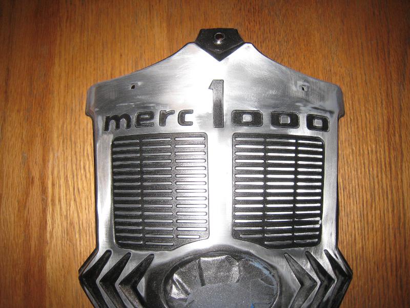

Didn't do much today. Stayed home sicker 'n a dog, real bad cold. Got some work done on the trim, some on the merc faceplate.
Trim was a bear to get some stuff off so I could move ahead. Suffice it to say I got off what needed to be removed and started setting it up for trim.
Merc faceplate got sanded with 220 to get the etched in stains out, then cleaned real well, primered, and this pic shows it after some sanding with 180. I'll gradually get finer with grits as I get all the paint and primer off the raised portions leaving black metallic in the lower areas.
