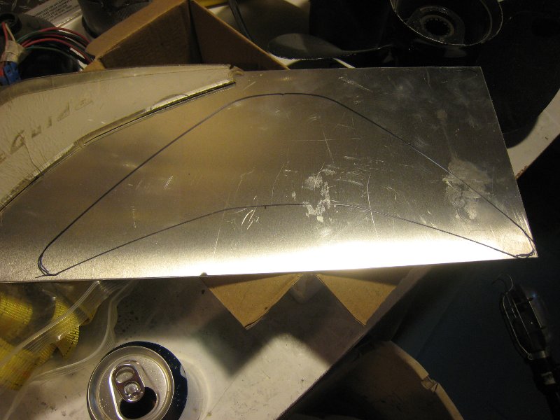

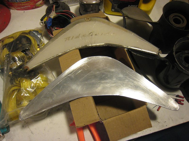

My Merc Rideguide faceplate was badly cracked, and all the holes were broken. So this morning before work I picked up a piece of 1/16" aluminum plate, and will let the pictures tell the story.
Maybe I should have got 1/8" aluminum, but for now, this can do. Good thing too, because as I was setting holes for mounting, the hammer slipped, and my old plastic face plate is now in 2 pieces. I think I'll paint it silver metallic, get a Power Cat sticker for it, then give it a number of clear coats.

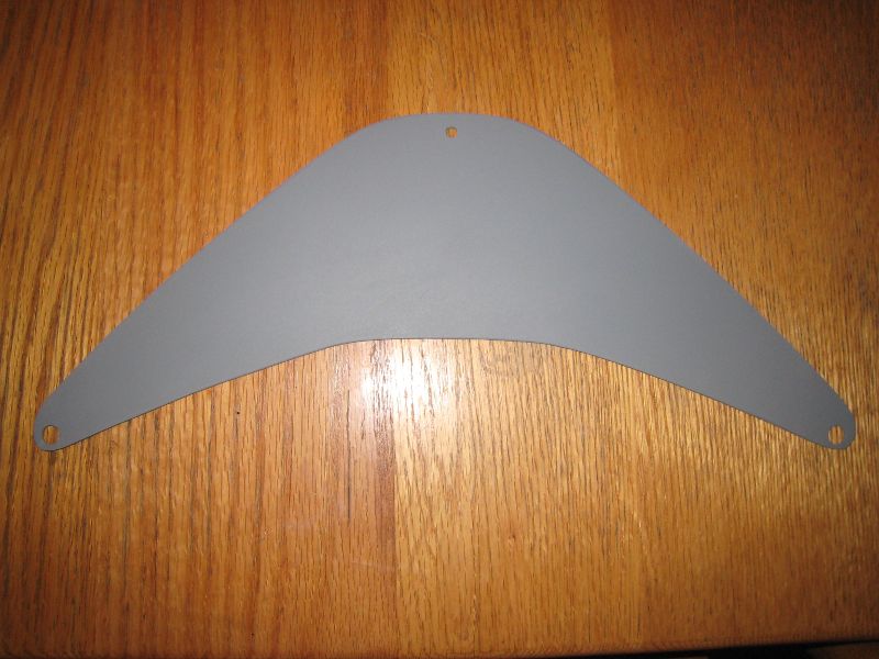

Cleaned it up one final time. Once mounted, I noted any inconsistencies and cleaned it up. I'll sand it again, make sure it's good and flat, and prime in the a.m.

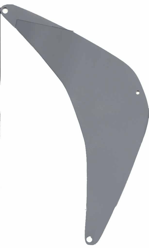

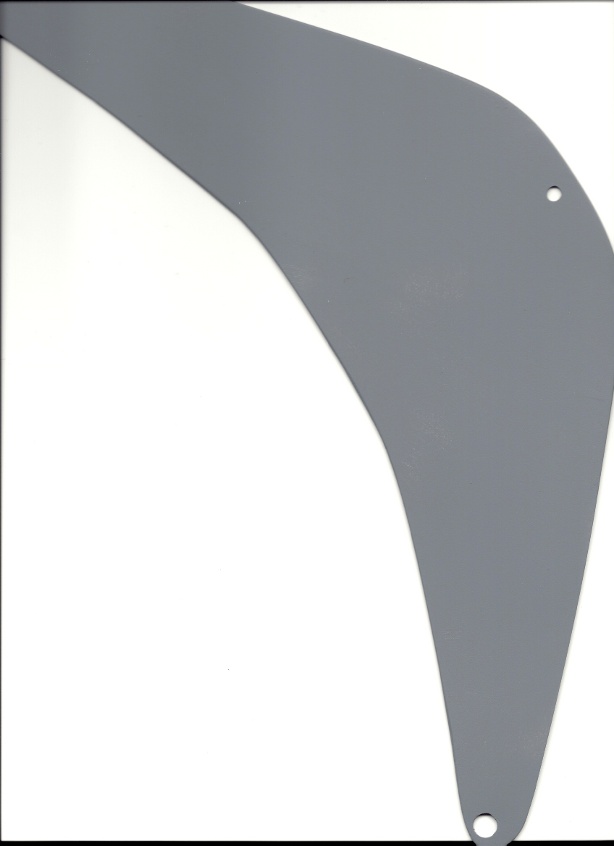

any chance you could post a scan of the template for me, mine is missing completely, Im thinking Ill get Crosby in the correct font engraved across the plate when I do one
nice job Frank
Re:New Rideguide faceplate 16 years 4 months ago #2500
Yep, I could do that later tonight. What, post it here, or email it to you?

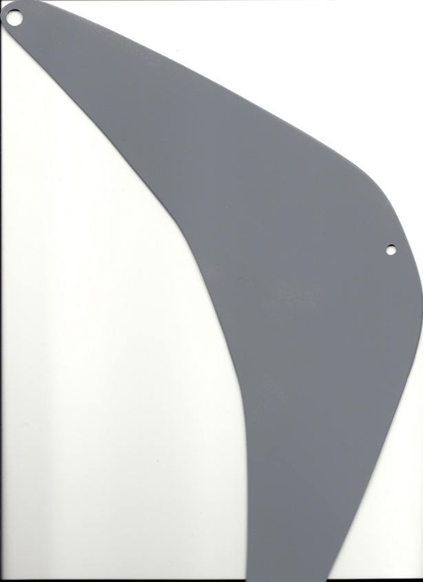

Mark, it needed sanding (a bunch, believe it or not!) and a coat of 7220 primer. I didn't think I would get a good scan the way it was. Got that stuff done, but primer needs to dry. Hang on to yer britches, it will either be later tonight or 1st thing in the a.m.

Just so you know Mark, after doing this, I think I would have done better with 1/8", given I don't have a scroll saw. I did this with a hand held jig saw, bench grinder, metal file and 80 and 120 grit sandpaper. It's in primer, so I'll probably scan it in the a.m.

post it here would be nice Im sure there are a couple guys that would like it too
thanks a bunch this will save some time :lol:

My scanner bed is not big enough, so you'll have to paste the images together somehow. Note: if I was to re-do it, the corner holes would be to the inside of the existing holes. As you can see, they are oversize because I did not get them right the first time. It still works okay.
Re:New Rideguide faceplate 16 years 4 months ago #2539
thanks Frank
I put the pieces together for those that dont have the software

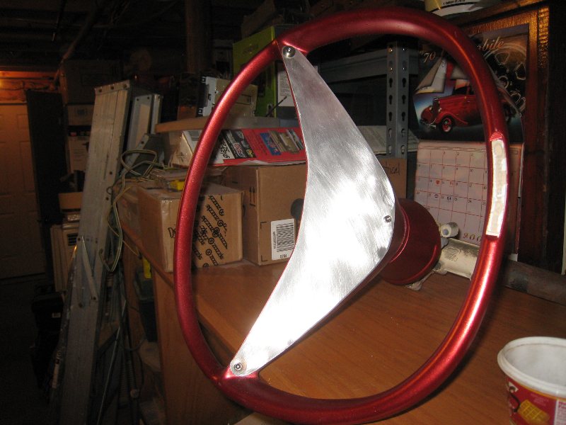

What a morning! Working on two faceplates, one for the steering wheel, the other for the motor.
The steering wheel one took the time this a.m. Worked hours in a photo editing program to get a Power Cat logo in shape for application on a black background. I think I'm there. I'm going to let the faceplate dry at least a day before applying the decal, then hit it with a couple (more?) coats of clear.
NOW maybe I can get to work on the power trim....
