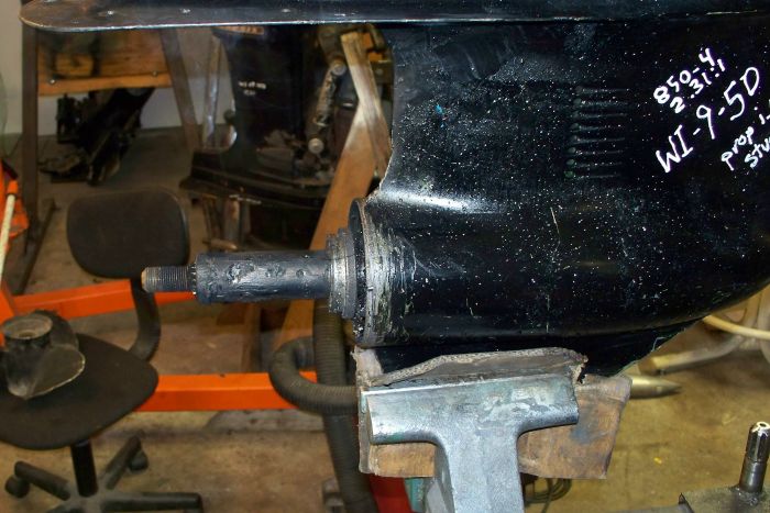

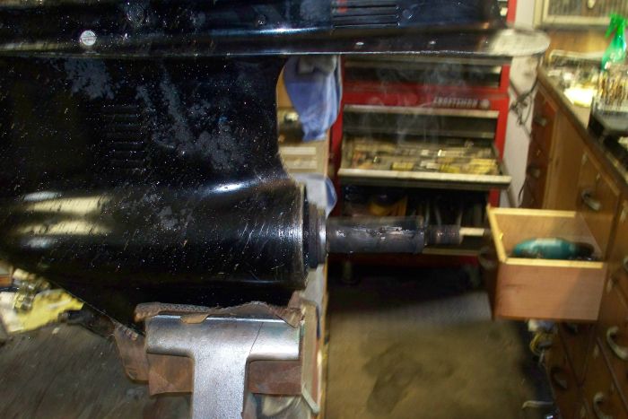

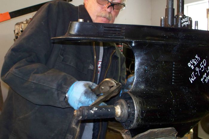

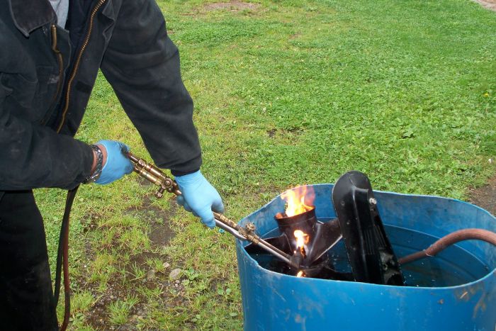

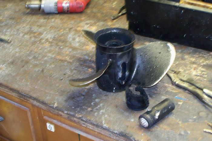

Re:prop removal 15 years 9 months ago #24283

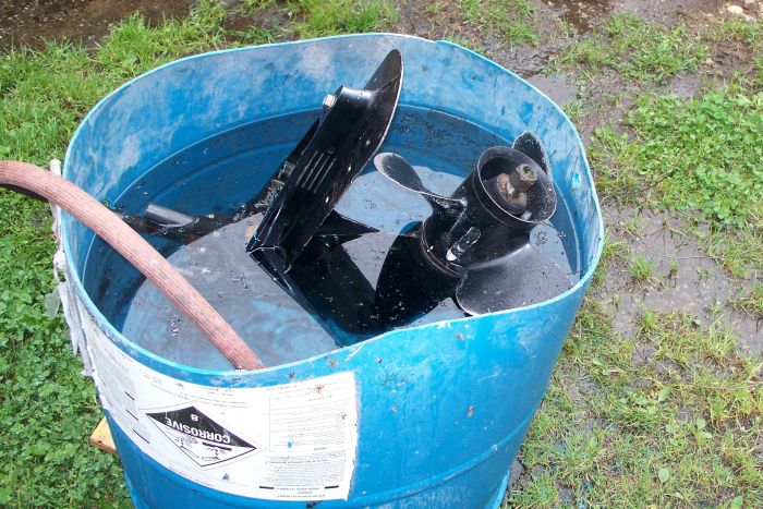

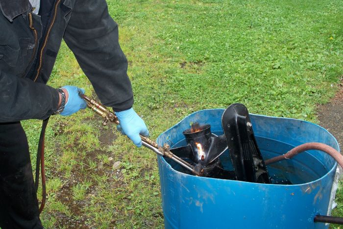

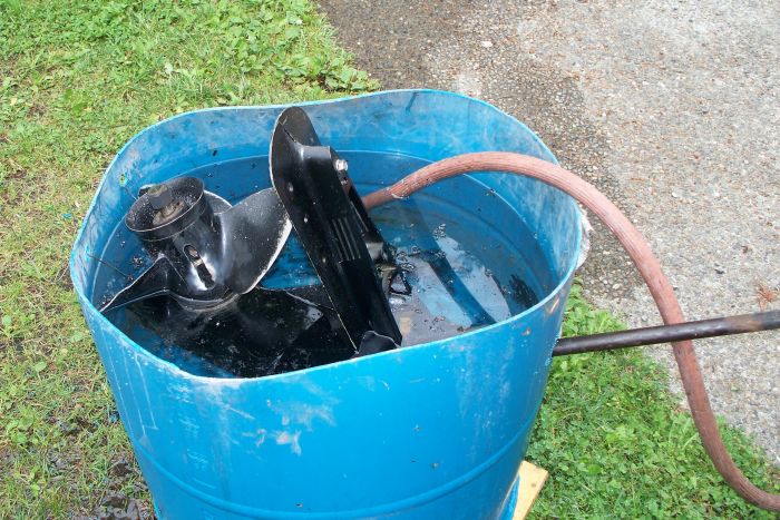

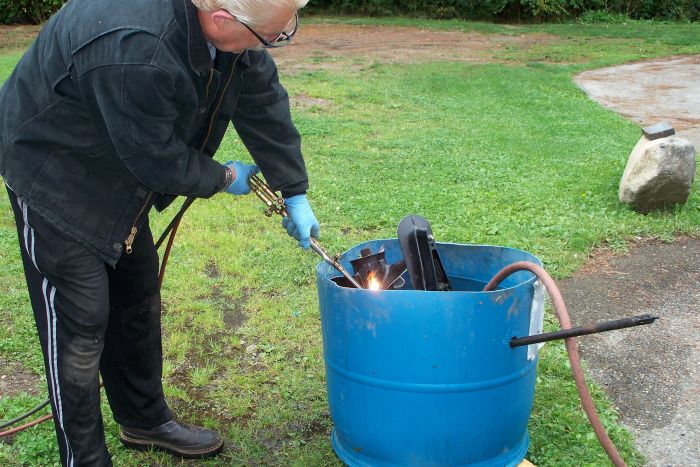

If you discover through efforts mentioned that the prop is REALLY stuck, any chemicals or press, or pullers will simply get the outer prop off and the rubber hub and internal splined hub will remain.
BUT,...If you get that far,...You can cut off the rubber and then properly heat the seized inner hub.
Or,..Drill holes through the rubber and after putting a large washer and nut on the end of the propshaft to keep the prop from shooting off and hurting someone,...Put the gear case in the water to protect the seals, etc and BURN the rubber hub out, the outer prop will 'fall' off and you can attack the inner hub.
