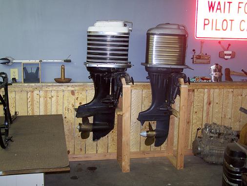

Got this on a boat this weekend.
Compression was real low on 1,3,5,6. 109 thru 118
Helicoiled on 2 and 4. I did not get the readings.
No faceplate.
It is a shorty though. Parts, parts.
I'm a sucker for the 6's.
This can't be even close!!
Now heres a pair to draw to.

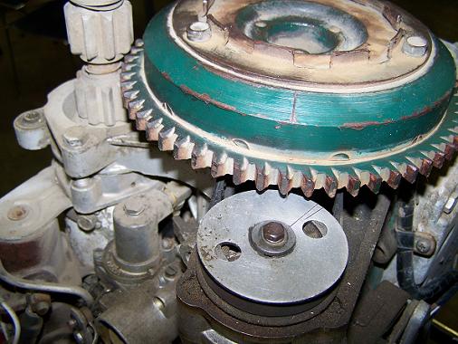

I've seen the timing marks run like that before. My 700FGS wouldn't run with them set per the manual. After refreshing the wiring harness, replacing the broken timing belt, and rebuilding the fuel system I couldn't get her to do much more than cough and sputter. Moved the belt one tooth (advanced ?)on the distributor gear like your pic shows, and she fired off and ran like a new one. Only thing my "Merc advisor" and I could figure was someone replaced the plug wires, and got them one hole off in the cap?

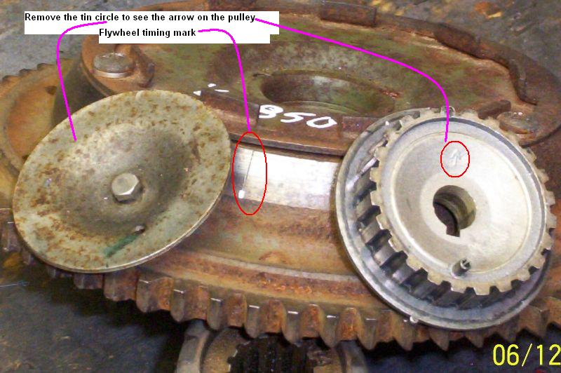

Timing mark, a cast in arrow, is on the pulley itself not the pulley cover. That looks like a home grown cover too, at least I've never seen one like that and I've seen a LOT of 6's.

Agreed the timing mark ( arrow ) is not on the cover plate. It is on the pulley.

the cover is not home grown it is merc correct.

Like everyone says - remove the cover of the pulley (part with the timing lines on it) and you will see the raised cast arrow on the pulley. The arrow needs to point at the center of the crankshaft when the line on the flywheel is pointed at the center of the distributor pulley.
On some Mercs there is also a TDC line stamped into the flywheel with a '0' stamp on the line. In that case the line with the 0 will align with one of those lines on the distributor pulley cover plate when the crank is TDC #1. Completely different from the line stamped into the flywheel that marks where the arrow and this mark are required to be to set the distributor pulley in sinc with the crankshaft.
If the cover plate being used is properly positioned on a matching distributor pulley those (2) holes will go on two matching raised circles for proper alignment of the TDC marks.
