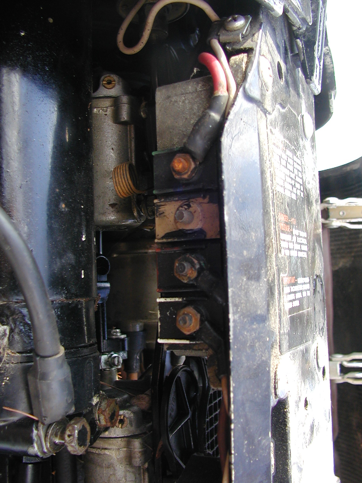

i picked up a 1977 150hp inline merc serial #4603127. i would like to fire it up but i don't have controls yet. does this ignition require 12 volts to the switchbox and if so which terminal. i have included two pictures(i hope).the top red wire goes to the coil,the third wire down from the top looks white,the bottom one is red.
thanks

Only one pic showed up and your text does not match the pic. It does need 12 V and it is connected to the red terminal which is the second from the bottom. The brown terminal is for a tach but some versions take the tach off the rectifier. Make sure you tighten that ground cable on the starter motor.

yes my text was wrong,the white is on the bottom and the red is above that,thanks dave. i will disconnect the yellow wires on the rectifier,thanks dave.

Re:150 hp ignition 15 years 9 months ago #23622
From top to bottom
#1 is coil
#2 is ket on off need + for run
#3 is + also to run
#4 isnot neededto ruN
Then ground from coil
remove the yellow wires from the rectifyer. jump the starter and it should start if not check for spark first.to stop remove wire from #2

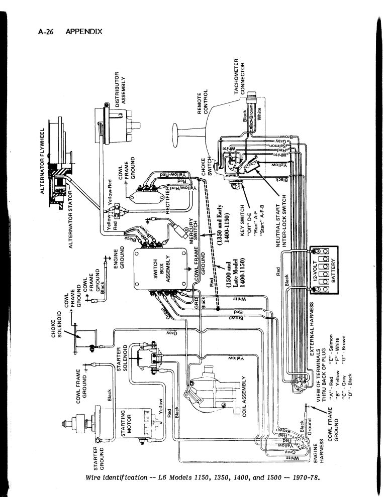

www.fiberglassics.com/fiberglassics-forums/mercury-outpost/paging-dr-frankenmerc#10093
(Scroll down close to the bottom)
It's on a 1970 model 1150, but I think (?) it's still good info for your situation.
Re:150 hp ignition 15 years 9 months ago #23656
Be careful as Dave B has it wrong.
Top Green terminal (red wire that should be green technically) coil.
Next down is the Brown terminal for the tach sender wire on old Quicksilver tachs. (not used with 6 pulse tachs)
Next down is the Red Terminal for the red 12v+ constant voltage wire.
Next down is the White terminal for the white wire which is 12v + only during start & run.
Below is the black (-) ground wire from the coil unless the coil is grounded to the crankcase.
You will need to apply 12v+ to both the Red Terminal & the White Terminal with the battery's (-) also being attached to the engine ground (-).
Once the beast is started you will need to dis-connect the white terminal's 12v+ supply to kill the engine.
Great point on dis-connecting the stator yellows!
Thom
Re:150 hp ignition 15 years 9 months ago #23687
thanks for the replies,it looks like that ignition system is the same type as the one in a 1971 65hp i had a few years ago. i am hoping to see if she will fire this weekend. it is 19 degrees out at the moment so i am not in any hurry to go out.

Re:150 hp ignition 15 years 9 months ago #23817
i wired the switchbox according to the diagram poured some gas into the carbs and she fired right up. the #6 spark plug threads seemed a little soft, what's the best way to fix the threads,helicoil?
