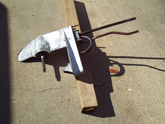

What's the trick to getting the L/U off. All nuts are loose and bolts removed. Can see small space between mid and lower but it won't come off. 2x4 on sides and cav plate no luck. Flat bar in gap still no luck?????

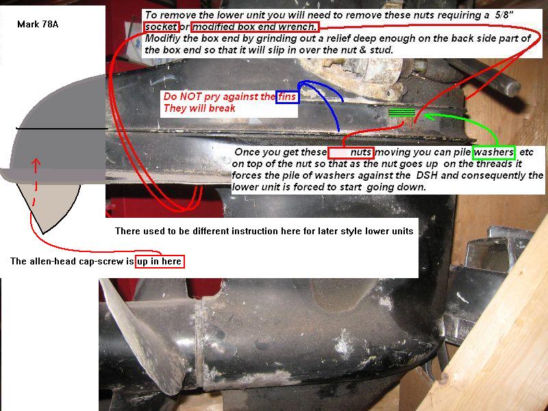

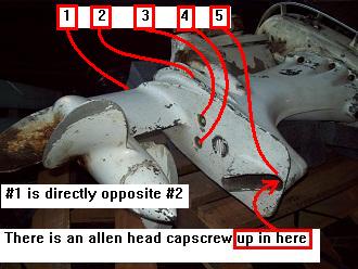

Sounds like you have enough gap established to eliminate this thought, but have you removed the allen cap-screw hiding up in the exhaust port under the cavitation plate?

Joe,
See the attached pictures that point out all the nuts and the allen-head cap-screw that need to be removed.
Read the tip on how to 'push' the lower unit away from the driveshaft housing to avoid prying on and most likely instantly snapping out a chunk of the horizontal fins that are so tempting to pry on.

Hey Thom, Thx for the instructions. I know I didn't remove that screw and there is no gap back at that part. I'm sure it will come off after that. Probably going to need help getting the powerhead out also. Thx, Joe

Hey Thom, Things come off much easier when you remove all bolts!! Go figure... Thx
