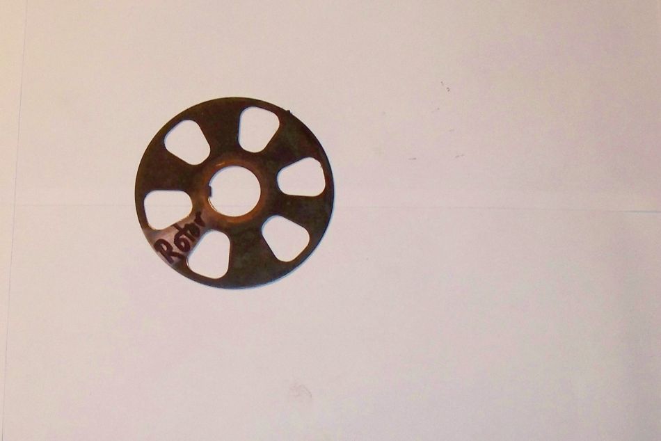

I will take a pic tomorrow and post it.
Re: ROTOR DISK ORIENTATION 15 years 9 months ago #23520
Just happened to have one handy!
Thom
Re:ROTOR DISK ORIENTATION 15 years 9 months ago #23545
Atta boy Thom! So the rule to remember here gents, is always mark the disk before you remove it if you can't find the stamp. Provided it was installed correctly first if course! But you won't be able to time the engine if it is in wrong.

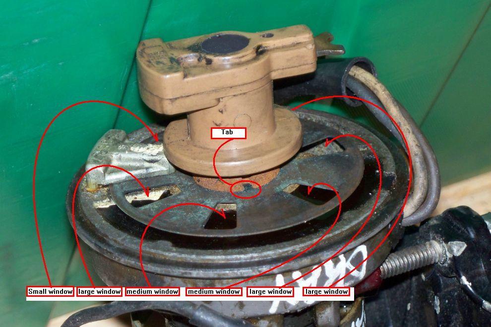

Re: ROTOR DISK ORIENTATION 15 years 9 months ago #23575
Or this one which is a little different.

Thom, Thanks for the picture, I really appreciate the effort but, that is for the earlier in lines where all the chopper windowss are symetric. The mid 70's direct charge had varying size windows on the same disk to slightly alter timing on each cylinder, Merc wanted certain cylinders to have slightly retarded timing.
So I'm still trying to answer "which side up"
The picture in the manual is not quite good enough to tell.
Randy

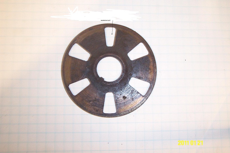

Re:ROTOR DISK ORIENTATION 15 years 9 months ago #23585
Hi Randy, I posted the rotor disc you need

Hi Dave, thanks, the pic did not come up the first time I looked at the thread (?) That is the right chopper wheel. Are you showing the this side up side? I don't see any markings on it.
Thanks,
Randy
Re:ROTOR DISK ORIENTATION 15 years 9 months ago #23603
Yeah I had a little problem posting the pics, then I ended up with 4 the same, then edited to the one you see. The surface that you are looking at is the surface that faces away from the distributor body (trigger) In other words, if the distributor was mounted on the engine, that surface would face down towards the prop.
Up and down being a matter of perspective on an upside down distributor think of it this way: the surface shown is the only surface available to write on when you take the distributor cap off.

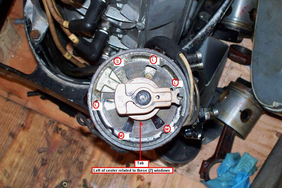

Re:ROTOR DISK ORIENTATION 15 years 9 months ago #23655
Dave has it right, but I worked too hard on this little tid-bit to trash it.
Thom
Re:ROTOR DISK ORIENTATION 15 years 9 months ago #23762
Your pics a keeper Thom, nicely done.
