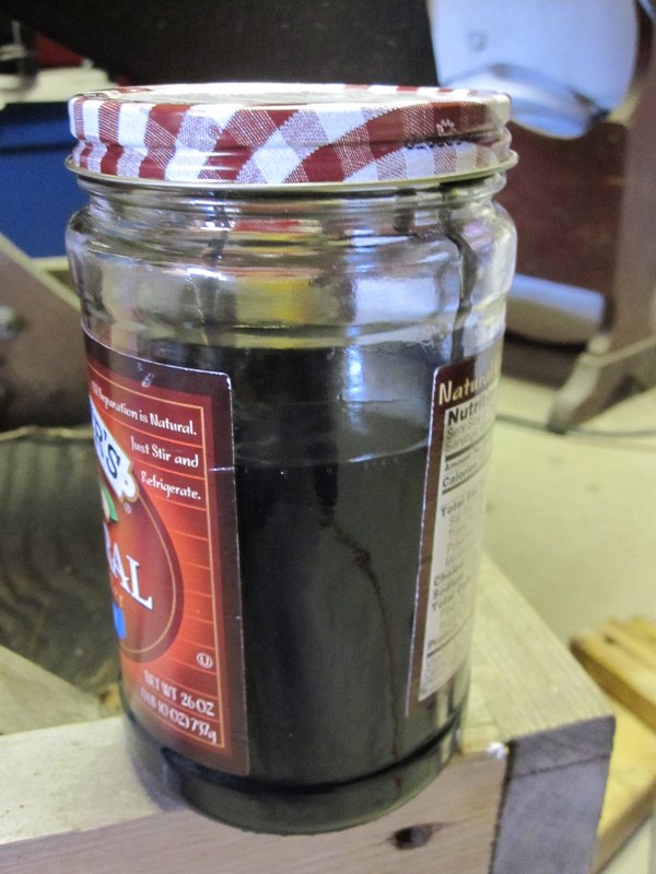

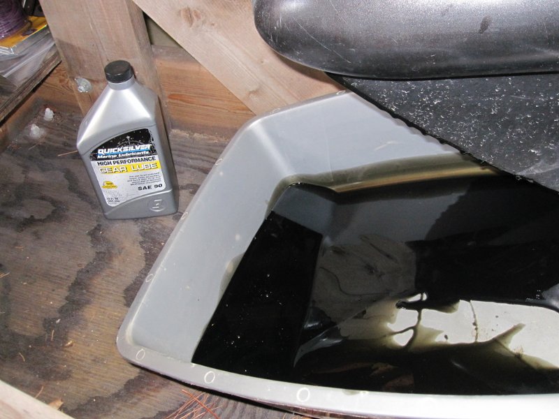

This is about all I'm getting out of the LU. Does that look about right?
That's the right kind of lube to use right? At least there doesn't appear to be any water in the mix!

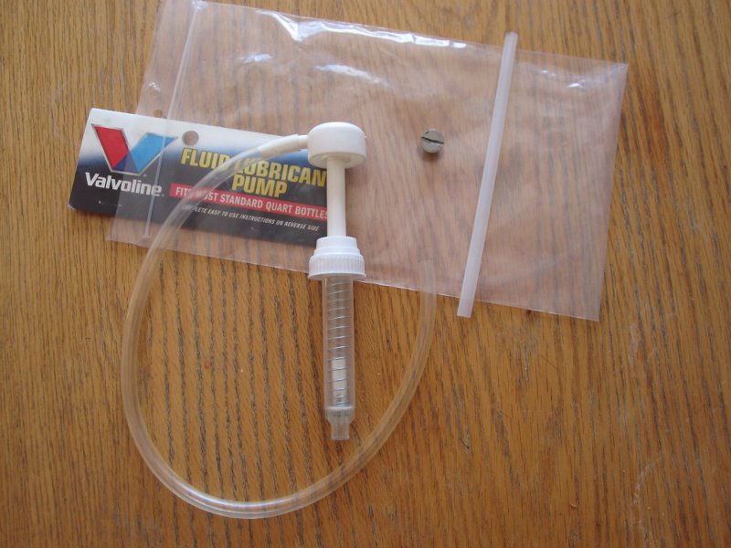

Also, I bought this pump to put the new oil in, but neither of the plastic hoses fit tight. Is there a better product that screws right in, or could I buy a nipple that would screw in that the larger plastic hose would just go over?

thats the lube i use frank. don't remember if my gizmo screws in, all i know is that its a tight fit. that looks like the right amount of fluid that comes out. if there was water in it, it would look milky.

Seems to me many moons ago I had a unit that screwed in Ron. The plug threads are not common, so I can't get a nipple for the hose. the larger hose that is part of the pump might squeeze in. Maybe I'll try that.
The lube coming out is as black as can be. Tim sealed that LU real well!

Frank - right pump, just purchased in the wrong place. A similar pump at West Marine or most marinas will have the thread-in fitting which makes things MUCH easier. I fumbled around for years with tubes, gooey messes and lots of wasted gear oil before I got smart.
As long as the oil that came out doesn't smell burned, it should be okay. It looks dark in the photo, though. Also, about how much came out? That doesn't look like much - should be about a pint, give or take. I use a bit more than a pint in my 1983 Johnny V4...

thats easily a pint if thats the kind of basin some people use in there sink to wash dishes.

Well, it smells, that's for sure Scott, but it doesn't seem to smell burnt. I have really nothing to compare it to.
Maybe I'll call West Marine today and see what they have for a pump. If they have one I can run up and get it.
I think I got a pint or more out. This is a 26 oz. jar, and you can see for yourself. That of course doesn't count for the amount that didn't get in the jar! (Not much I believe.)

New gear oil also smells " bad "
That is the way it is.
The pump should have a fitting on it with 3/8 NC thread ( standard ) except for " off shore built motors "
