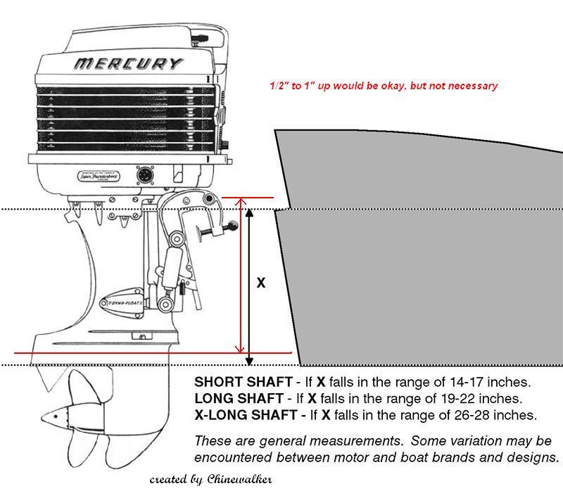

How does one determine if your boat is better suited for a long or short shaft motor?

The attached picture should answer your question.
If not,...Ask for more clarification.

That graphic looks vaguely familiar - glad to see it's still kicking around! I put that one together about 5 years ago...

Check out the drawing now.
Credit where credit is due amigo!
Thom

I like the engine choice.
And fins!
Very informative.
Well done.

Awesome! That answers it perfectly.
Thanks Thom. (and Scott)
