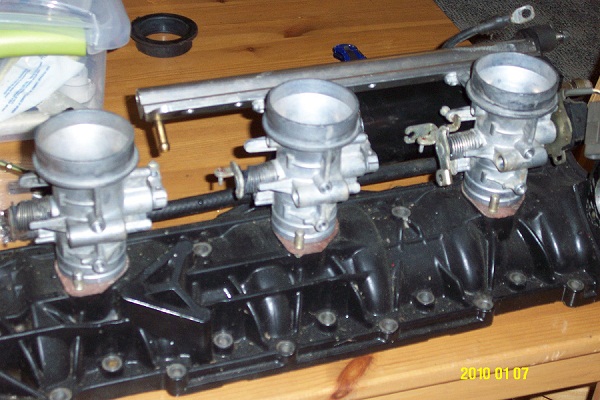

This should work Frank, I re sized it. Just a teaser, as you can see I am fitting it with 46MM throttle bodies. I will post a pic of the finished intake manifold less the fuel pump and fuel rail.

Re:Hi Thom 15 years 10 months ago #22973
Wow, pretty slick Dave. Keep up the great work!
Frank

Frank, Thom knows the story on this build but I will share some info here as well. I built a fairly stock 1150 for my bass boat and added integral trim and tilt and a sweptback gearcase along with a jack plate. You might call that my daily driver. The 1500 block was purchased in Chicago, some 600 miles from me, Road trip. I decided to start where Merc left off with the 1500 and 1400 and detail the block, clean up casting flaws etc. It was originally slated for std. pistons till I came across 6 Persan pistons .030 over. Since nobody really does blind boring around here I started to build my own boring mill. Part way through that process I met up with and became friends with a local machine shop owner who gave me the full use of his shop. I set up an old bridgeport mill from the 60's and my block and bored all 6 holes .030 over. There was a great feeling of accomplishment doing the boring myself. I was about to assemble it when I came across a triple throttle body from a 1994 Polaris Snowmobile. The fuel injection computer that runs it does not need an o2 sensor since the snowmobile is 2 stroke as well/ Bonus. Then comes the secret part ( lets just say I can adjust the fuel map on the computer, on the fly, with my laptop) :cheer:
I hogged out the intake throats on the standard merc intake and adapted the 3 throttle bodies. There are some mods to the standard reed blocks as well since the goal was to get as much air flowing through as possible since I now had the capability to push as much fuel as necessary.
While I was at it I converted the block to accept an adi front plate and switched the beast over to ADI. Nothing is sacred in this build. I fabricated all new linkages for the throttle bodies and a custom fuel rail 8N (lots of fuel). The timing linkage is also modified so that the throttle bodies don,t open till the timing is all in, same as merc. From there the fuel map is modified to maintain the stoichemistry needed to keep the pistons in their original form....solid. These are high dome .030 over. My design criteria is for a wot of 6500 rpm, fairly modest. Im sure it is capable of more since everything is balanced and blueprinted. The entire package fits under the standard cowling and will replace the existing 115 block on my bass boat. This block will be run...hard.
More later.
