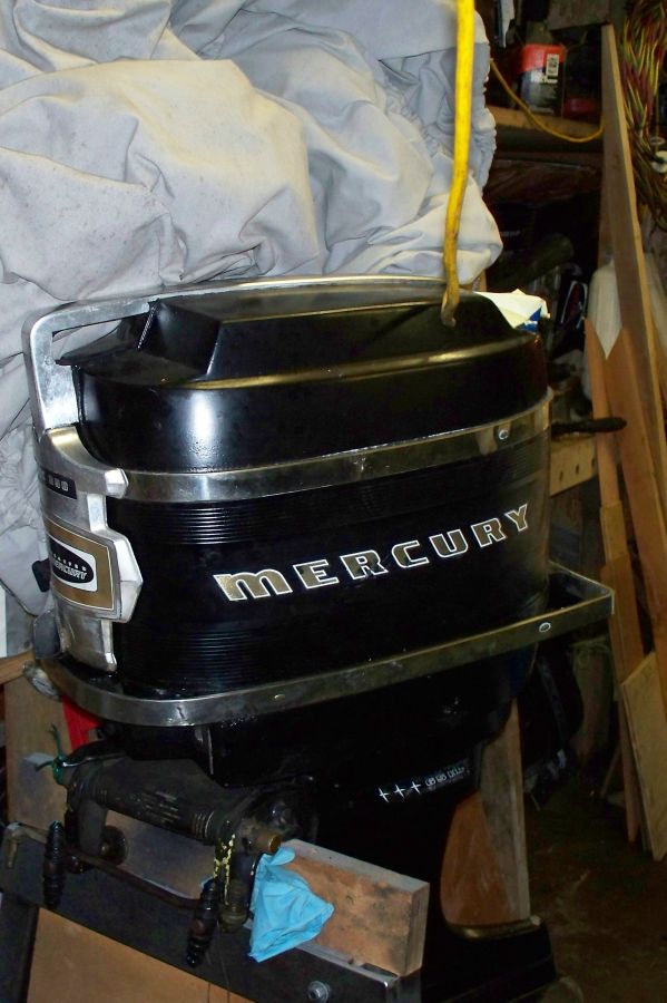

That pic is of my l/shaft George! Where did you find it? I took it in the Carrick Roads, Falmouth, Cornwall, England 2009. Sadly it is salt water but always has a serious 1hr + flushing session afterwards, inc. Xsalt or similar & antifreeze in the winter. Luckily our end of season club meet is in fresh water.

i think someone should do a collage of 65 triples & make a birthday card for George with it! ;) :laugh:
