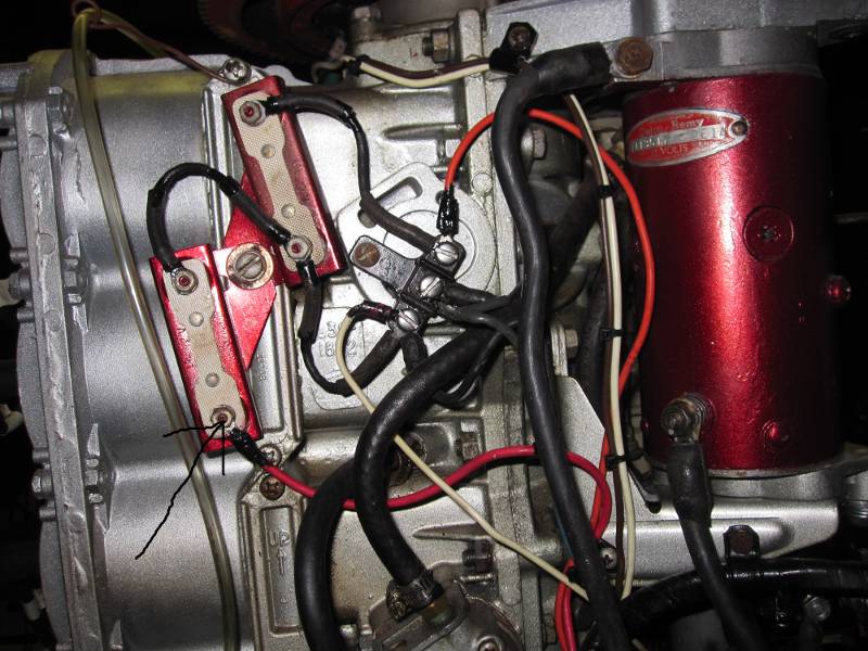

Re:Tach wiring - '62 Merc1000 15 years 10 months ago #22529
I put in an aftermarket tach Doc, no brown wire coming out of my harness. This is straight from the back of the tach. Can pulse from the tach still go to the gray wire from the regulator?
I have power going to a small post on the solenoid, the post near the big one for 12v+. I believe that turns the tach on when the key is on, so I'd do that purple and keep the ground black?
Thanks Thom. Happy New Year!
Frank

Re:Tach wiring - '62 Merc1000 15 years 10 months ago #22533
Yes
Incorrect.
The purple wire will need to go to the ignition 'ON' 12v+ terminal on the primary side of the ballist resistors, which is 'E' Black on the factory wiring diagram.
The (2) small terminals on the starter solenoid do the following: (1) should have a ground strap on it with the other end to engine ground (starter body, etc)
(2) should only have the yellow wire attached from the internal harness. It is the wire that only shows 12v+ when the ignition key is turned past 'on' to the 'start' position as the yellow wire activates the starter solenoid which makes the starter spin.
It doesn't matter which small terminal is assigned to these 'tasks'. One does one task and the other does the other task.
Thom

Re:Tach wiring - '62 Merc1000 15 years 10 months ago #22536
12v to this post?

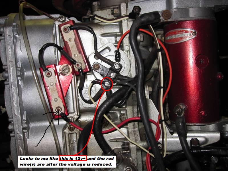

Re:Tach wiring - '62 Merc1000 15 years 10 months ago #22547
Not correct Frank.
See the attached picture.
Thom
Re:Tach wiring - '62 Merc1000 15 years 10 months ago #22557
I'm real confused then Doc, but that's not new. I thought that block was a ground block, but it has a red or orange wire going to it. The middle screw is where the ground from the hood attaches.
No matter, I'll wire the tach 12v into where you say it needs to go. Thanks for the help, I appreciate it.
Frank
Re:Tach wiring - '62 Merc1000 15 years 10 months ago #22570
Frank,
It is not a grounding block - it is just a terminal block where wires from the internal harness connect to wires that go out to other components.
The rusty screw at one end and another one in a like position at the opposite end do thread into the engine block and 'could' be used as a (-) ground terminal if desired, but the (3) screws in a row that all have wires on them only thread into the plastic - not clear through to the engine block.
The center wires (blue)that you said is the ground for the top hat are actually the momentary 12v+ to operate the electric choke solenoid (up in the top hat)when the choke button is pushed down. One blue wire comes to that terminal from the internal harness and then connects to the blue that goes up in the hat (choke solenoid).
The actual ground for the top hat (which is required so the electric choke can have a decent ciruit) is usually a braided ground strap that is fastened to one of the retaining machine screws (phillips head I think)that holds the choke solenoid to the top hat and the other end of the ground strap goes over to one of the (2) cap-screws that holds the timing and idle stop adjustment plate onto the top area of the distributor housing.
Thom

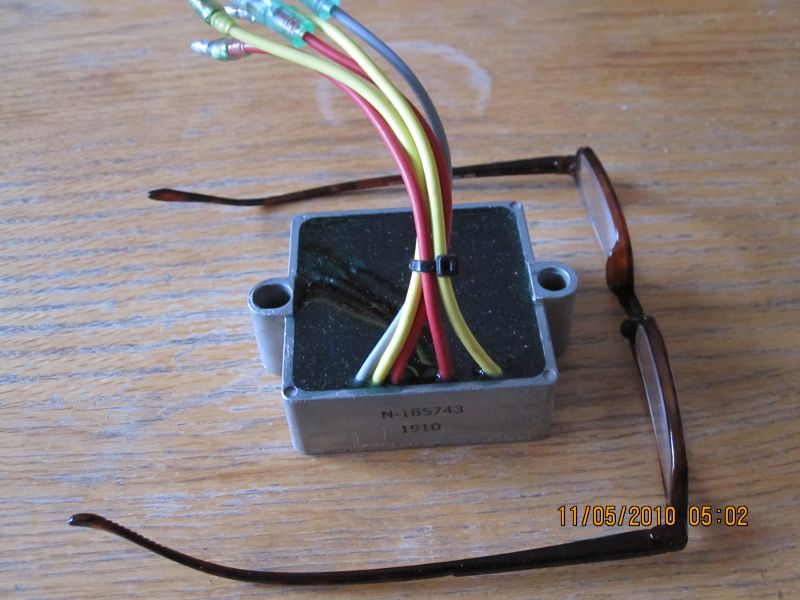

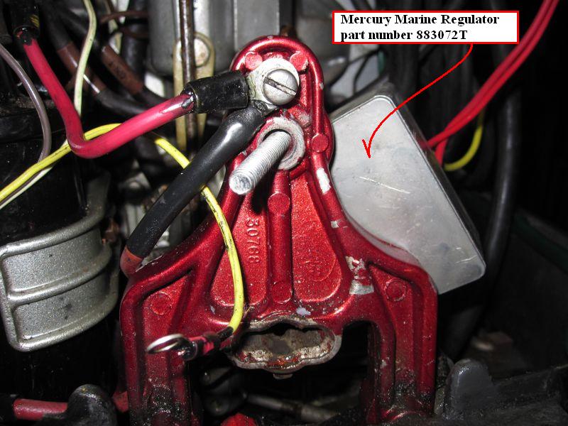

Re: Voltage regulator wiring - next question 15 years 10 months ago #22618
Can I use this mount both as a ground for the voltage regulator and as a junction for the 12v+ wires? I don't think so, but want to be sure. It would work so well if I could!
I tapped a 10-32 hole on top where you see two 10 ga. red wires loosely attached. I still need to run the two from the voltage regulator there, but don't want to do it till I know for sure if this would work or not.
I didn't have the right size bolt to attach the regulator, but will pick one up soon. It is hanging where it will be mounted.
What do y'all think?
Thanks!
Frank

Frank is using a regulator with a built-in rectifier off a later model Mercury O/B.
Although the stator may not put out the AMPs that this regulator will handle,...It will control his stator output voltage to 13.8 rather than allowing it to spike to 17.5 +/- vdc.
This is a great retro-fit for use with today's batteries and other resistance issues.
Frank,
I don't know what those red wires do for a living,...BUT you can NOT use that bracket as a terminal block for 12v positive (+) connections.
It will be just fine as a negative ground (-) terminal block and place to mount the regulator and its black (-) ground wire,...Provided the regulator is secured off to the side of the hole that the face place needs to go through and secure itself.
Thom
Re:Tach wiring - '62 Merc1000 15 years 10 months ago #22692
Thom, as you may remember, this regulator does not have a black ground wire. It needs to mount to something that is ground.
I figured this face plate mount would do da trick. Also, the way the VR is shown in the pic in my last post is the way it has to mount so it does not interfere with the face plate
I didn't figure I could us the mount as ground and a 12v+ block, but it was just an elegant and clean approach. How about if I installed a nylon washer or two to prevent contact?
I can take that 8 or 10 ga. red wire that comes from the wiring harness for the controls and was attached to the side of the rectifier straight to the big positive lug of the starter solenoid right? (That would be a good solution too! If not there, where would be good?) I know I attach the two red wires from the new VR to the big positive lug of the starter solenoid.
It's nice not to be in a rush. Probably can't go boating for a few months. ;)
Not much left to do here, then I can just clean the old tower or power up and cover it till it's time to re-install. All I'll need is a bag of 50's for gas the way it's sounding!
Thanks again for all the help Doc.
Frank
Re:Tach wiring - '62 Merc1000 15 years 10 months ago #22700
Frank,
Yes,...You could drill that hole out enough to slip in a nylon sleeve for your machine screw to pass through, and add a nylon washer to either end of the nylon sleeve and then use that as an insulated terminal for 12vdc(+).
Rather than use a terminal block (which can over time become a point of corrosion and resistance) I think you would be better off to simply put both of the red wires coming from the regulator together in one end of a butt connector and then run one 12ga from the other end of the butt connector to the big red primary on the solenoid.
I forgot that your new regulator (Sierra Marine?) doesn't have an external ground wire and simply needs the regulator housing to be grounded.
T
Re:Tach wiring - '62 Merc1000 15 years 10 months ago #22702
Thom, I can run both red wires from the new VR together in a ring terminal and easily attach it to the big positive lug of the solenoid. That's not a problem.
My question is, can I run that big gauge red wire from the wiring harness that used to be attached to the side of the rectifier to the big positive lug on the solenoid?
Sorry to keep bugging you on this, but I am a firm believer in asking questions (as you've no doubt noticed). I just want this to be done correctly.
Once I get this done, it's back to tach.
Thank you again for all the great help!
Frank
