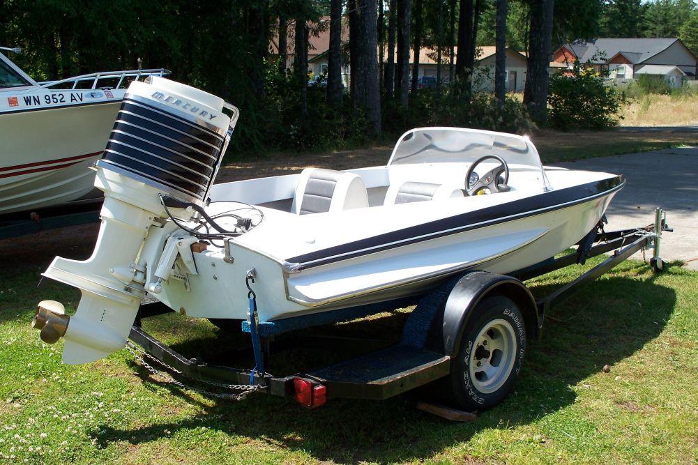

I don't have a jack-plate on my G3.
I run a 15" transom with about a 1.5" shim and a 15" (shorty) mid.
It goes fast enough like that.

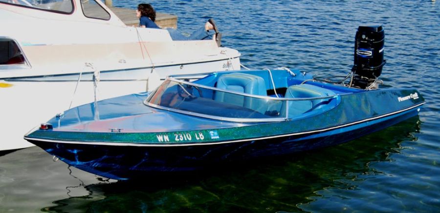

I do have a CMC power tilt on my Pleasurecraft and run that 140 Stack about 3" higher than stock with a surfacing small ear chopper.
It runs about 63 MPH set like that. The Pleasurecraft is a 16'- Sidewinder clone.
I'm sure someone has run a 20" motor on a 15" transom successfully with a jack-plate. Due to the original construction of the older G3 though, where the edges of the transom are simply fiberglass'ed to the aft end of the hull and sub-floor,...I would definitely re-construct and add some knees up off a set of new and much stouter stringers before hanging that kind of weight up so high on a shorty transom.
