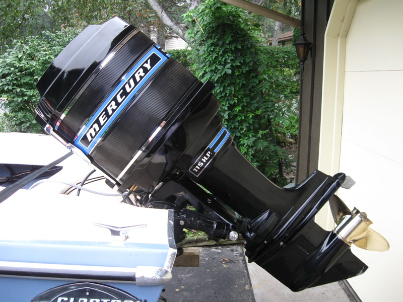

Have to be a serious collector, or cheaper than 2010 stuff.. I got
same 1987 model 115 ,with that faceplate at a cycle shop 2 yrs ago with control box. $ 200 . My friend has now , never got my Custom
Craft going, back injury , etc...

Well, I'd say, This would be a place to buy a ready made motor for your Fiberglassic. Looks like he does nice work. If you weren't into working on you own motors.
There are fiberglassic guys and there are outboard guys. Plus there are guys who do both. B)

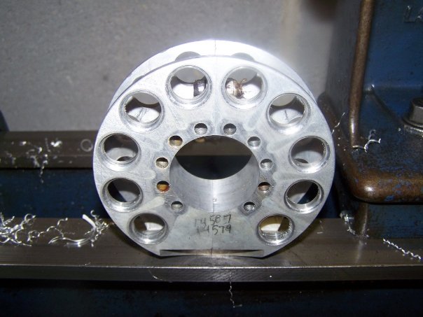

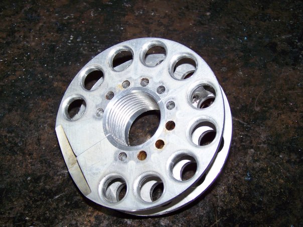

The reed blocks are a critical part of a rebuild, especially in the 6 cyl. The top and bottom ones rarely pass inspection to be re-used.
When the labrynths wear out primarily due to crankshaft 'wobble' the bypassing crankcase pressure can hamper the ability to have good idle quality.
Since they are NLA and rarely come up on eBay in NOS condition I have experimented with re-machining them.
A machinist pal up in Canada took on the task for me and created a set of blocks for me.
He milled out the middle of the blocks and then created an insert with new labrynths to fit in the blocks returning the I.D. of the blocks to 1.245". The inserts were pinned once in place.
This process returned the labrynth-to-crankshaft clearance back to original clearances.
I've heard that the bleed restrictors found in the transfer port area (intake ports) have a significant roll in idle quality too.
I've also heard that they do not.
I lean towards them being part of idle quality and have been replacing missing ones when I assemble.
The original style restrictors leave some to be desired and although I haven't done it yet, I believe the Professor's way of correcting their failure rate is the best I've seen suggested.
That is to tap out the holes just deep enough to house an insert and then thread in an insert with the proper sized hole drilled to be consistent with the hole size in the original plastic inserts.
Professor,...Would you please re-post the tap size and related insert size you use please.
And do you use brass or steel inserts?
Are these inserts installed with an allen wrench?,..Or?
And what size hole do you drill in the inserts?
Thom
hum-m-m-m??? tried to post pictures of the reed block repair, but a link prints rather than a picture??? jpeg format, 70KB?? Anybody know why??
