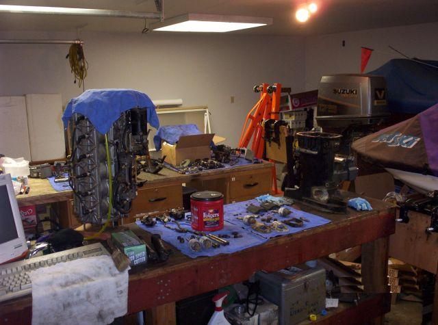

Well, I was able to get the lower end off today and it looks like it's frozen. I'm going to have too try and take it apart and see what's up. I don't have a manual yet or a parts breakdown. I think I can get it apart and back together if I can find the parts breakdown diagrams. Worked on my Rude Fat Fifty that way no problem. ;) Rebuilt a Citroen motor in my carport, when I lived in Rota Spain, without any manual. Of course that was just an overgrown VW motor with overhead cams and I was only 25 then. Wow, a quarter century ago. Sucks getting old.....
I'll try and take the power head off next I guess and see if I can clean it up. Anything I should worry about taking it off, beside the coils and throttle linkeage?
I'm thinking I'll spray it down with Purple Power and maybe hose it off at the $.25 carwash. A little too cold to just use the garden hose. Or should I just use the Ceaner and wipe it down with a bunch of old rags?
That's enough for now, getting late.

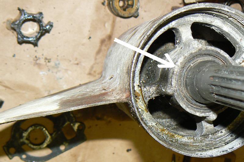

OK, I've started taking the lower unit apart but I'm stuck.
How do I remove this bearing housing? Also notice what was left of the impellor!
Does this unscrew counter clockwise?
Do I need any special tools for this?

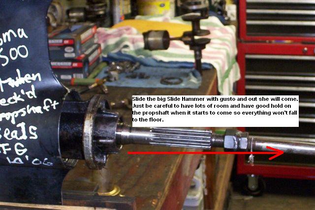

Re:800FGS now what? 15 years 11 months ago #21506
Make up adapters for a puller to go to the bearing housing.----Push on the end of the propshaft.
Or an adapter for a slide hammer on the end of the propshaft and see if you can pull the propshaft and bearing housing out together.

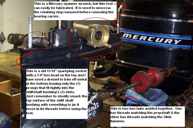

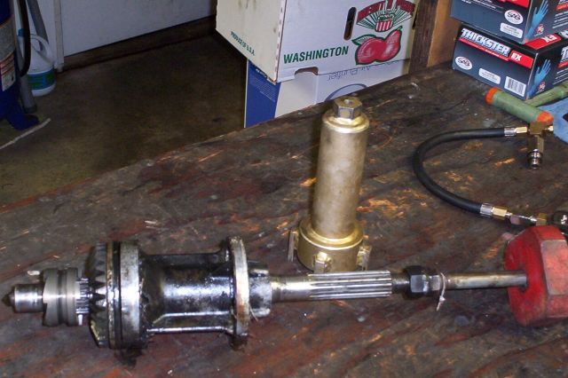

Re:800FGS now what? 15 years 10 months ago #21740
I have attached pictures with instructions on how to dis-assemble the gear case.
HTH,
Thom

Thom, Thank you for the pics, look easy enough to fabricate. Also Looks like I may as well look for another lower unit then since even if I remove everything I won't be putting it back in since the current case is cracked.

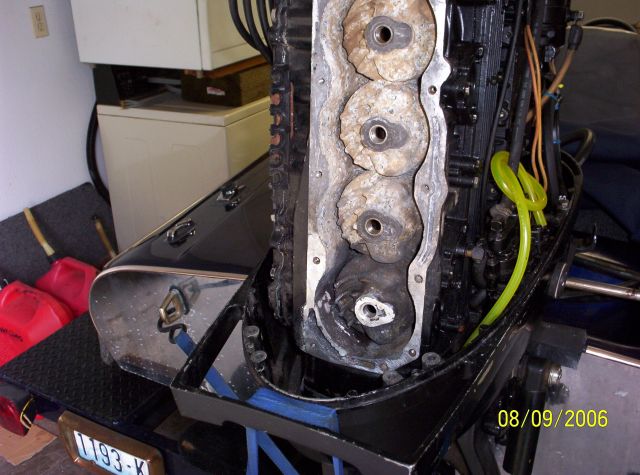

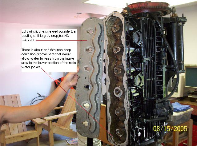

Re:800FGS now what? 15 years 10 months ago #21834
Bob,
The 'head' on these Mercs is just a water jacket cover and removing it won't give you a better look at the cylinders or pistons.
All the readings are quite low, but other than the 120, the others aren't too far apart in numbers.
I would be tempted to fire the beast off and let her run for 10-20 minutes at a fast idle, periodically squirting some fogging oil in the carbs as she is running.
Once the powerhead is warm to the touch, shut her down and then run new compression tests.
If the beast hasn't run for several years +, it is very likely they will all come up 15-20 psi, and it would be interesting to see what numbers you come up with.
I have attached a couple pictures to show you what is under the 'head'.
It is best left alone if it isn't leaking too much water out around the spark plugs when running.
Thom

Thanks will keep that in mind. Nice collection and work area. I'm jealous, wish I had that much room to work. Is that a skeg weld job for yourself or customer engine?
Re:800FGS now what? 15 years 10 months ago #21905
Frank,
Man-o-man do I wish I was back in full swing, but I'm not, and the surgery was a real foul-up on the surgeons' part. I might have to re-visit the operating table.
The pictures are several years old, and I am just sharing some 'shop history' through them.
Bob,
Yes - I am very fortunate to have a nice lil shop to work my Mercury Magic in.
It has real decent lights that I snagged out of a large office downtown that was remodelling and gave them to me free-bee.
There are (3) sets of 4 foot florescent bulbs - I think there are (6) or (8) bulbs per fixture.
I am very fortunate to have good heat, plenty of room, and I really like the way I set up the work benchs.
I can spread a project out on one bench as is shown, and keep the other one clear (dreaming) for use with other repairs as needed.
It doesn't really show very well in the pictures, but there are actually (2) work benches that are about 8 ft long running parallel with each other. There is about 3 ft between them and my tools are mostly located at one end, making a 'U' shape pattern.
I have the floor padded between the benches where I stand most of the time.
I have a nice chair to sit on and take a break when my back and legs get really painful, which happens way too much these days.
I've attached some more pictures - at least I can do that.

Well tinkered around with the lower unit today. Made a tool out of an old spark plug socket as Thom suggested and got the shift rod out. Like Neil's lower unit mine is sry as a bone inside from what I can tell in the shift well. I still have to make a shaft and bearing puller to get the prop shaft and bearing housing out. Hopefully I'll be ablr to grt to that in the next day or so.
P.S. Thom I hope your back is starting to feel better, we'll keep you in our prayers.
Just a thought here. Looking at that impeller you need to find ALL the missing bits or you can/will have serious cooling issues. The broken off impeller pieces can find their way into the cooling passages in the powerhead blocking of ports & causing overheating issues. You need to do this before you run it at all IMO.
Geoff UK
Re:800FGS now what? 15 years 10 months ago #22059
  • Waterwings
  • Waterwings's Avatar Topic Author
  • Posts: 4902
  • Karma: 107
  • Thank you received: 100
Geoff,
Good point. I was wondering that myself when I took it apart and saw that. I'm going to check the lower unit some more. I probably need to take the "cooling cover" (nomenclature?) off the head and see how it looks inside before I attempt to run it. This is starting to look more and more like a complete tear down the rate I'm going.

Well, tried messing around with the lower unit again. After turning upside down and bouncing it off a board so to speak some of the impellor parts came out, along with water out of the shifter housing, gee go figure.
questions: How do I get the drive shaft out?
Shouldn't that come out before I try and pull the prop shaft and bearing carrier assembly?
If I use a puller can I just pull the bearing carrier assembly off the prop shaft as it comes out of the lower housing or do I have ti use the dent puller attached to the prop shaft method?
Re:800FGS now what? 15 years 10 months ago #22127
pull the propshaft out and take the nut off the driveshaft then pull it out with the upper bearing and waterpump base.pinion will fall off.
Re:800FGS now what? 15 years 10 months ago #22301
