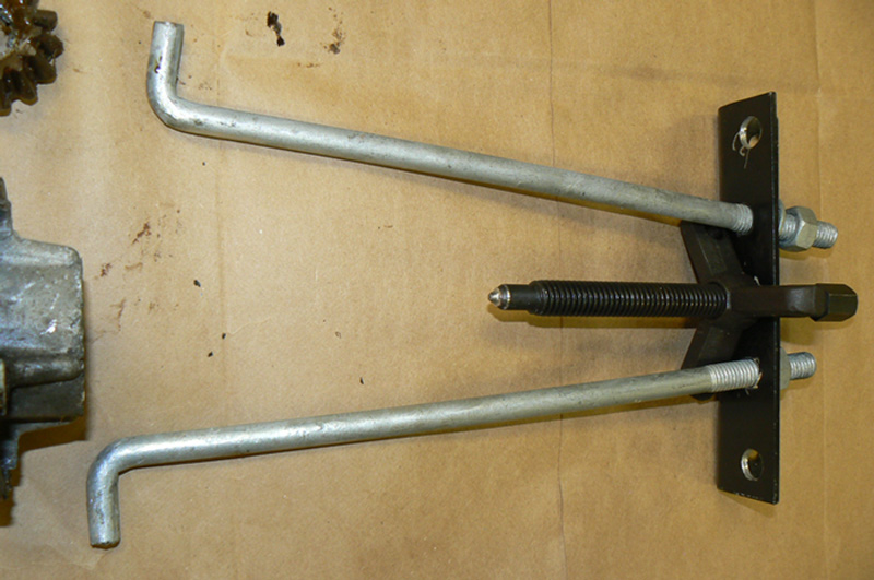

Thanks go to Scott (Chinewalker) for the heat advice, it worked like a charm. Well, worked well with the prop shaft and my home made puller.

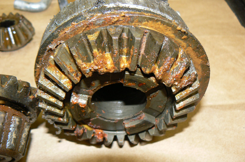

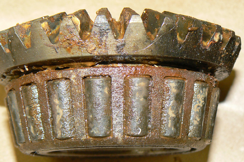

Here are the gears, not too bad. The drive shaft gear needs new bearings of course.
Needle bearings will need to be replaced obviously.

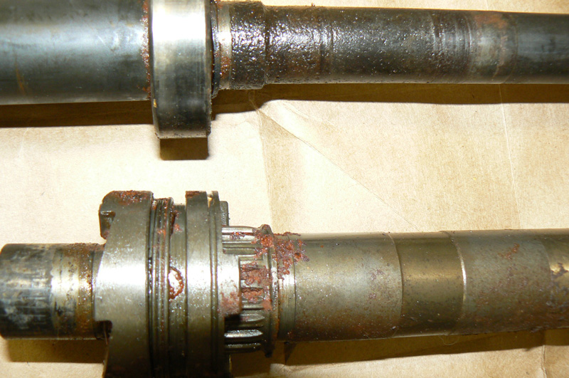

Here's what the prop and drive shaft look like.
Just need a good cleaning I think.

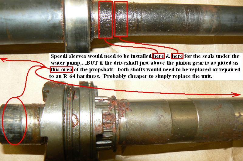

Re:800FGS now what? 15 years 9 months ago #23309
Bob,
There are still too many old lower units in much better condition to justify messing with what is left of this one.
I don't think I would try and re-use the gears, even with everything else corrected. If they were the last set around - they would possibly survive for a while, but better gears are around.
See the attached photo regarding the shafts.
