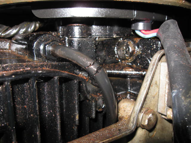

Just checking the beast over & I have spotted this split pipe (see picture). I think it must be an oil transfer pipe lifting oil to the top bearing as it runs right to the bottom of the block? Other than possibly leaking oil what effect would this have on the running of the thing? I would think cyls 1 & 6 would run weak?

The broken tubing needs to be replaced and is critical to the survival of the top main bearing. With it cracked, etc the fuel mix also leaks out and gets on the wiring consequently swelling the insulation and ruining the rubber cowling mounts.

Get that tubing fixed before you overheat your upper crank bearing.

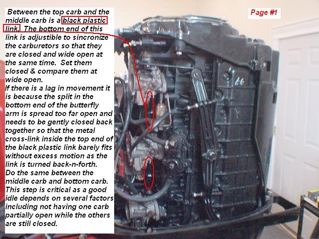

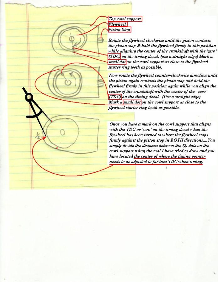

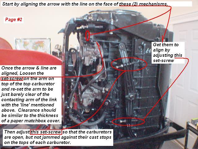

Re:1884 115 Carb questions 16 years 8 months ago #2084
Geoff,
Yes - simply remove the Idle Stabilizer. That is all there is to it.
In regards to idle quality - if all the compression readings are relatively even I would suggest going back through the link-n-sync process.
I'm going to try and attach the link-n-sync process for adi fired Stack-6s.
It consists of (5) pictures so there will need to be this e-mail and (2) following to post them all.
Note: the following pictures contain the Primary Pickup Timing numbers for a 140 not a 115 so be sure and follow the 115 numbers found in the last picture in this series.
Thom
Re:1884 115 Carb questions 16 years 8 months ago #2085
Hum-m-m-m? Looks like only one picture posted.

RATS,...Looks like one picture per post so here is #3 of 5.
Thom

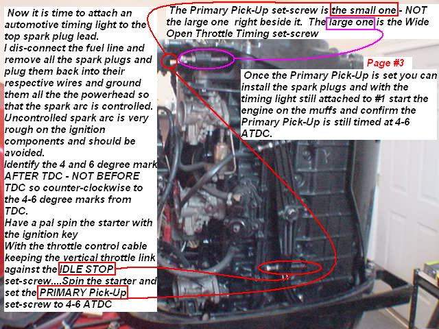

Re:1884 115 Carb questions 16 years 8 months ago #2087
#4 of 5

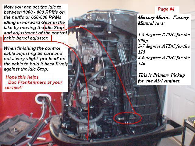

Re:1884 115 Carb questions 16 years 8 months ago #2088
And #5 of 5.
Be sure and follow the specific sequence in the pictures.
Thom

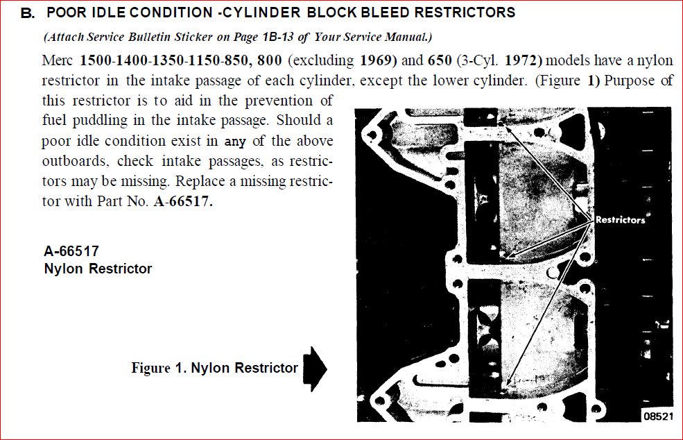

Re:1884 115 Carb questions 16 years 8 months ago #2115
Poor idle can also be caused by missing " bleed inserts "
on the motors equipped with them they are usually missing.
I install 8-32 stainless setscrews with the wee hole drilled in them. They will never fall out again.
Re:1884 115 Carb questions 16 years 8 months ago #2118
Fabulous forum, as usual a wealth of informtion shared. Your advice Thom is always eagerly welcomed along with the other masters of these inlines.
In regards to bleed restrictors, I have the attached info from an old service bulletin. Hopefully it helps.
