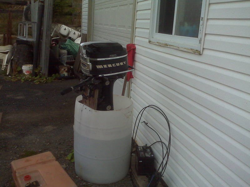

Good day:
The seller is having trouble giving me an definitive answer on this motor. Can any of you Merc experts narrow it down to a year? Also the HP?
Thank you in advance. Appreciate the help.
Re: Help ID old Merc 15 years 11 months ago #19514
1965 is the decal paint scheme year. Either a 110 or a 60 hard to tell for me between those two models.
Conrad
Re: Help ID old Merc 15 years 11 months ago #19523
Ask him to check and see what 'name' is cast onto the starboard side of the block.
I think one will be 'COMET' and one will be 'LIGHTNING', but I'm not sure since I just went out and checked what I believe is a 9.8 and it has Lightning cast onto the block, but has Comet above it in white paint stamp or decal??
Real helpful aren't I. Gag
:S
Thom
Re:Help ID old Merc 15 years 11 months ago #19525
It does strongly resemble a 1965 6hp I had a long time back.
Re:Help ID old Merc 15 years 11 months ago #19529
65 comet is 6 lightining is 9.8.
