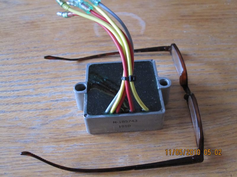

Got my new voltage regulator today. I plan on mounting it to the bracket that serves to lock the front cover plate into place, and is also where the rectifier is mounted. Sierra part # is 18-5743. I got it at NAPA. Here's a pic and the ground instructions.
Thom Adams (Doc) already told me how to wire it. Yellow to the wires that went to the rectifier, red bundled together to the solenoid, gray ignored. Makes sense to me. Winter project once the motor is off the boat and in my shop. Looks like there's a chance I may be able to get out once maybe twice more before pulling the motor. We'll see.
Frank
Re:New voltage regulator for my '63 Merc1000 16 years 4 days ago #19083
Frank,
I don't recall whether or not I told you, but the gray wire is the tach sender wire used with the tachometers that read off the stator and have a 6 pulse (not cylinder) setting to use on the back of the tach.
If you are using a tach that reads off your ignition then you would simply tape it off as you wrote.
Thom
Re:New voltage regulator for my '63 Merc1000 16 years 4 days ago #19097
Yep Doc, ya told me dat. I thought fer sure I kept a Word copy of all that stuff, but nope, cannae find it. Looks pretty simple though, just yeller to yeller, tie da reds togetter and run to the same post on da solenoid I got one runnin from da rectifier now (yer da one clued me in on dat little trick). Gray fer da tach, tape off.
