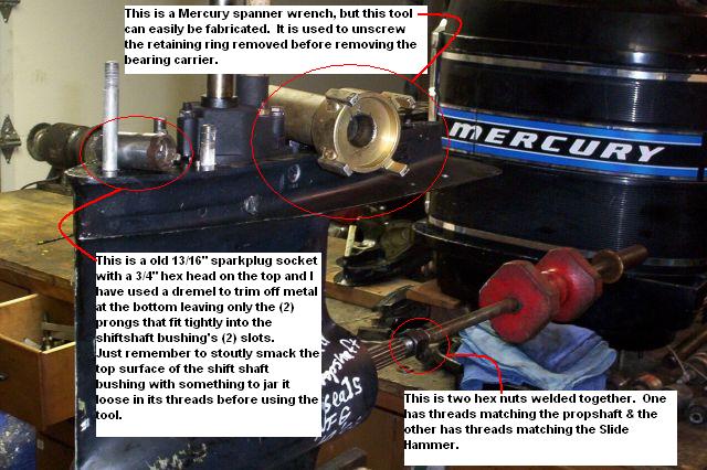

Lower unit is on my bench, I want to disassemble and inspect the whole thing. I was able to get the threaded ring removed, but I can't get it any further apart. I actually cracked the casting of the internal piece (gearbox?). My lower unit is in pretty rough shape, bad electrolysis. Ideally I will replace it.
I would like to take it apart though. Any help?

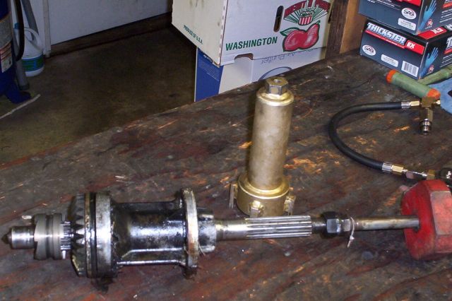

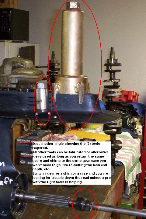

See if the attached pictures help.

Hey Doc, great pictures!
I actually welded up something for my slide hammer as well. Unfortunately not before I cracked a piece of the bearing carrier loose. Heating the housing and the slide hammer worked, I had to really roughhouse with it though.

Thanks Thom! I have a line on a new bearing carrier so I am just going to replace that along with some new seals and spraybomb.
